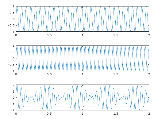

Just to circle back, if you have machines at 16.6 and a sinusoid at 14.4, that will indeed cause a beat that sounds like 2.2hz. But it should not excite any resonance at 2.2hz. In amplitude modulation terminology, the 2.2hz (or actually half of it... 1.1hz) plays the role of an “envelope” frequency and (14.4+16.6)/2 = 15.5hz plays the role of the “carrier frequency.
More specifically, let’s look again at that simple trig identity I mentioned: [cos(A-B) + cos(A+B)] = 2*[Cos(A)*cos(B)]
Let A = 2*pi*15.5*t; and B = 2*PI*1.1*t
Then the left side of the identity is cos(2pi*15.5*t -2pi*1.1*t) + cos(2pi*15.5*t +2pi*1.1*t) = cos(2pi*16.6*t) + cos(2pi*14.4*t)
And the right side is 2*[ cos(2pi*15.5*t)*cos(2pi*1.1*t)
LHS = RHS...
cos(2pi*16.6*t) + cos(2pi*14.4*t) = 2*[ cos(2pi*15.5*t) * cos(2pi*1.1*t)
These are just different ways to express the same thing. The left side is a sum of sinusoids, the right side is a product of sinusoids.
The right side is what you’d recognize easily in the time waveform.
The left hand side is what you’d see in the spectrum. 2.2hz does not appear in the spectrum and will not excite any resonance. Adding excitations at different frequencies does not create any new frequencies in a linear system.

> electricpete - thank you for the detailed explanation. I can understand the carrier frequency idea from my days as a electrical technician but I have a hard time understanding why the carrier wave could not create an excitation that matches the carrier wave frequency.
Perhaps my idea to mention amplitude modulation made things way more complicated than they need to be. A signal with modulation index <1 will have carrier frequency present but a signal with modulation index 1 will not.
Forget amplitude modulation and look at the trig identity. It is an equality. Only one side of the equality represents the spectrum (the side that is the sum of sinusoids). That side of the equation has only the machine frequencies, not the difference frequencies. The other side is the side where half the difference frequency shows up as an multiplier (envelope).
You mentioned superposition. Superposition relies on having a system that is linear time invariant. In a steady state LTI system, the only frequencies that are present are the frequencies of the excitation (input). That's because the only operations done within such system are addition, multiplication by a scalar, differentiation, integration, delay...none of which can transform a sinusoid to a sinusoid of a different frequency. It's an important concept imo.
> Consider I have two pieces of equipment on spring isolation bases. They both move in oval pattern but for the sake of this discussion consider just the forward and back motion. They both operate a different speeds but occasionally both will be at the far forward position at the same time. So at that time both are creating a force through their isolation systems in the same direction at the same time. The frequency of this occurrence (I think) is then the 2.2 Hz and the amplitude the sum of the two forces. Is this not the right way to think about it?
I'd say it's correct that you have a peak of the envelope occurring at a repetition rate of 2.2hz, but you don't have a signal that is exactly periodic at 2.2hz (or 1.1hz) if you look closely at what the signal is doing within that envelope. If you created such system and looked at it on a spectrum analyser (frequency domain) you should see only 16.6hz and 14.4hz. If you looked at it on an oscilloscope display (time domain) you could make out features related to 2.2hz/2 and 15.5hz, both those frequencies are not present in the spectrum and will not excite a resonance.

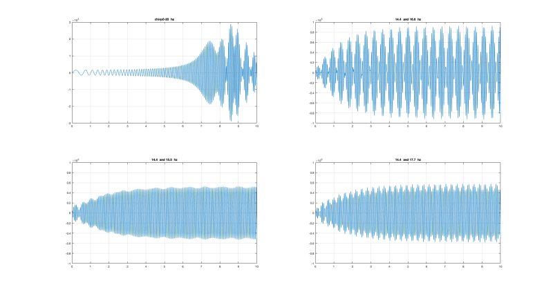

Question for the panel
consider a single degree of freedom spring/mass/damper system
Tune it to 2.2 Hz
Apply the 14.4 and 16.6 Hz, forces, simultaneously.
What frequency(s) will it vibrate at?
Now run it at 14.4 and 15.5, or 14.4 and 17.7
Is the amplitude greater or smaller?
My guess is that the 15.5 case will give the biggest maximum displacement, simply because we have a lower frequency input into a low pass filter. The 2.2 is not a real physical excitation in some fundamental fashion.

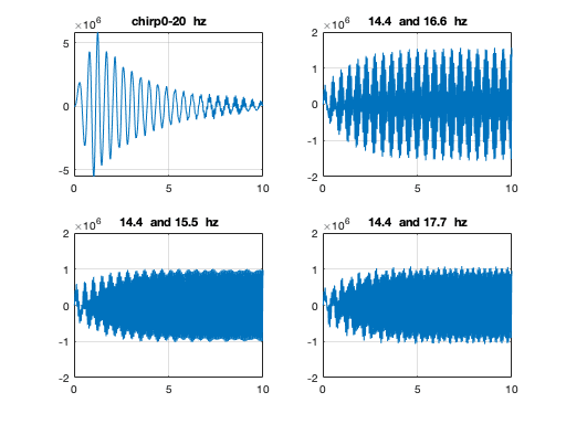

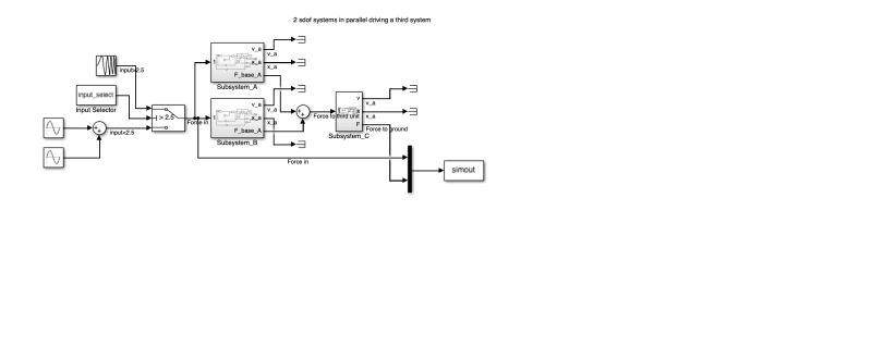

Thank you again for everyone's time on this. I clearly need to study this concept some more since the match and what I am intuitively thinking about motion of the machines is not correct.
and then this is the two tables sat on a third mass, which has a resonant frequency by itslef of 2.2 Hz
This is the force into the ground
here's the model
So the 2.2 hz exists, it is excited by the chirp, but makes no odds to the response to the excitation at 14.4 + 15.5,16.6 and 17.7 Hz.
Note that this model assumes that the subframe is very heavy compared with the vibrating tables, which may or may not be true. I'll come up with a better model later.
