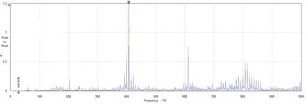

Hello good evening, I have doubts about indicating the harmonics or bands in this spectrum that is from a reduction box, to try to identify if there is an imbalance or misalignment or other problem. Can anyone help? Thank you.spectrum gearbox.jpg
Accessible three-way straight cut bevel gearbox with 1.5:1 ratio (20 gear input).
1689 rpm. My doubt is identify 1xrpm 2 xrpm etc. Thanks
1689 rpm is 28.15 Hz. You may have some 2nd order at twice that
Something doesn't add up, you'd expect to see at least some content at tooth mesh frequency.
Where your peaks are most likely the gear mesh frequencies. Around the main peak, you can check to see if you have sidebands that match the running speed of either the input/output gear.
Comparing to previous measurements may help you to determine if there is increased wear.
As PJMechanicalEng has already said, 1689 rpm = 28.15 Hz = where the marker is on the far left. What software are you using for the spectrum analysis ? Most have cursors such as harmonic, side band, bearing frequency, etc. that you can enter the running speed (and other details) to help identify where 1X, 2X, 3XRPM (or otherwise) are located.

Was measured vertically with a sensor end cap close to a bearing.​
I want to identify on the spectrum 1xrpm 2 x rpm 3 x rpm to find a possible an answer to an yellow alarm that give on acelaration on g.
More informations should be fine to give you help (machine type, amplitude @1x, waveform type, gear schema and teeth.....)

the sidebands around frequency around 400Hz (i suppose to be GMF) seems to be not at 1X but lower, 1X and 2X are not visible in this view type but value seems to be very low.
From your details seems to be the problem (if present) is related out of unbalance
Probably misalignment problem could be present if GMF is 200 Hz about
