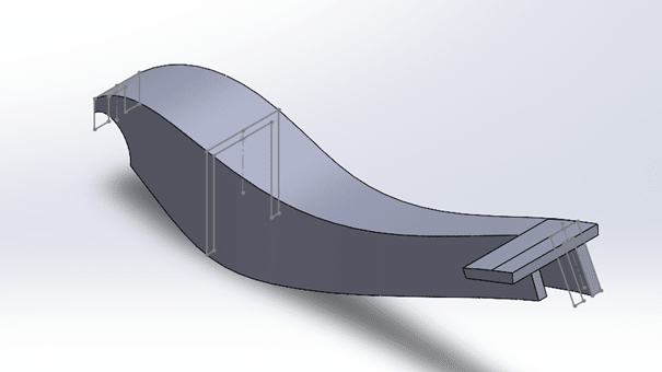

Hi all,
I am new on this forum. Im a mechanical engineering masters student.
For an assignment, I am designing an overhanging beam, and optimizing it for weight.
Due to production and material choices, we went with U (channel section) beam.
To minimize weight, I want to vary the cross section along the beam. To approximate this, I have subdivided the beam into three sections with a different cross section thus different moment of inertia, see pictures. I was getting along with the calculations, but now have 8 constants to solve for and only 6 (7 if v3=0 is counted) boundary conditions. Im also hesitant about how I set up my calculations in terms of Inertia for the second cut.
Could anyone point me in the right direction as to how to proceed?
Thanks in advance
Thanks in advance.

I should have clarified, I have already calculated reaction forces and constructed my shear and moment graph. I was now trying to implement the three different cross sections.
That said, I will take a look at macaulay's method, thanks!

It is a brake pedal.
oh and Desertfox, we were not allowed to use FEM on this assignment and the material was a CFRP composite so a castellated beam would be suboptimal and rather complex to calculate in this particular situation. Here's a screenshot of what the optimized cross-sectional shape of the composite part of the pedal looks like now.
That looks like an interesting project. If you could express EI as a continuous function, it would be possible to express M/EI as a continuous expression which could be integrated from end to end.
BA
Hi DansailV
I didn't mention FEM.the castellated beam was just a means of reducing the weight of the beam but keeping the beam cross section constant however now you have told us what the beam is for I can see it wouldn't be suitable[smile]
If a straight line variation is used for EI, from maximum at support B to 0 at points A and C, then M/EI is constant for the full length, which should make it easy to analyze. Of course, it is not possible to have an EI value of 0, so a minimum value would need to be introduced at each end, in order to resist shear.
EDIT: Or, since a specially fabricated shape is contemplated, make the elastic Section Modulus S, linearly variable so that maximum fiber stress is constant throughout the length of beam.
