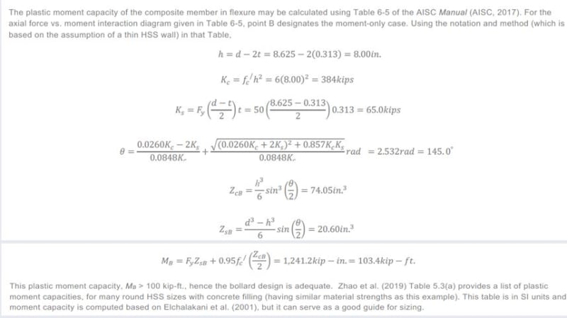

Can anyone give me a bit of a hint about where this comes from? I guess it's part of the AISC...

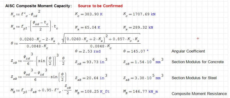

I get a Mr = about 50 K_ft 81 K_ft (wrong fy). with a Zx = about 21 in^3. I'll post my SMath program when it's finished... I'm not sure how it misses the mark... I haven't finished the program yet to check output... I've always used 'light', 'medium' and 'heavy' bollards based on experience from damaged ones. I've not used energy for checking. I don't know how this 'shakes out' but Packard is well known in HSS design.

I thought it was a neat article. Dimension units are consistent. It appears that the approach is using Working Stress Design. I've put together a SMath program for it and it appears to be at least dimensionally OK. Does anyone know the source for the formulae presented in the article as I noted above. I've also looked at the Canadian CSA S16 composite flexural strength using our LRFD and the bollard 'fails'; I've got to re-check the numbers before I post it.
