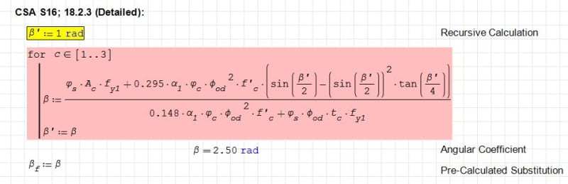

Does anyone know what the 'theta' value represents? The CSA S16 code has a similar recursive (first time I've used SMath for recursive calc and it seems to work OK) calculation and returns a similar value. If you use 5 iterations, you end up with the same value and it takes more than twice as long. I've set it to a fixed variable to use in future calculations, else it seems to do the recursive calc each time the variable is used.
I cannot find the error... it seems like the Canadian code uses a lesser component of the added concrete... maybe someone else can find an error if it's there. Feel free to use and/or modify.
[URL unfurl="true"]https://res.cloudinary.com/engineering-com/image/upload/v1634743749/tips/Steel-Bollard_rmegjj.pdf[/url]
[URL unfurl="true"]https://res.cloudinary.com/engineering-com/raw/upload/v1634743749/tips/Steel-Bollard_bikxbt.sm[/url]
