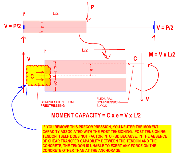

I disagree. If we simplify things by looking at an undraped, unbonded post tensioned member, I would say that is exactly the case. How could it not be since, in that scenario, all that the post tensioning does to the concrete member is exert a compression at the anchorages? Note that, for the purpose of this discussion, I'm assuming that there is no mild reinforcement in play.
Ingenuity said:
How does you #4 logic work with a case of unbonded tendons placed mid-depth (no eccentricity) with no drape?
It works as shown in the equilibrium sketch shown below. Note that the sketch can easily be extended as follows:
1) Shifting the straight tendon provide to any vertical location does not appreciably change the model.
2) Introducing tendon curvature only modifies the effective, vertical location of the precompression.

For unbonded PT, the precompression is applied "externally", i.e. at the anchorages (anchorage block is pulled against concrete by tendons).
There is a tension force at the location of the unbonded tendon in this case - that is correct. However, the effect an unbonded tendon in ULS would be to provide force from initial strain & stress (after losses!) and a very small amount of additional strain (<=100MPa according to EC2), due to reasons explained above. Thus, KootK:s claim that "for unbonded PT, the compression is the reinforcement" is not incorrect per se.

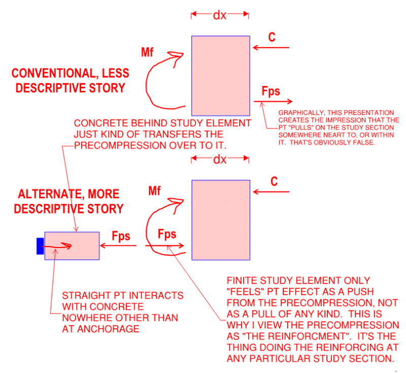

I'm not surprised. The conventional presentation of flexural strength in unbonded PT does a poor job of elucidating this aspect of things in my opinion. It took me a long time to arrive at this particular insight and doing so required studying detailed FBD's of the concrete in isolation of the PT, treating all aspects of the post-tensioning as external actions.
The conventional presentation is obviously geared towards drawing parallels between PT design and ordinary reinforced concrete design in acknowledgement of the logical progression that most of us experience as designers. While expedient in that regard, I feel that presentation tends to obfuscate some important facets of unbonded PT mechanics.

I disagree. Because unbonded PT is not composite with the concrete that surrounds it, I believe that PT can indeed be treated as an external action without any loss of rigor in the analysis.

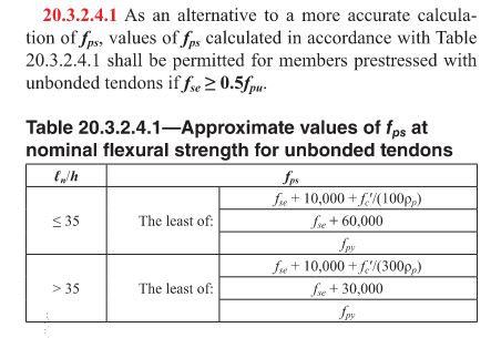

In the hypothetical scenario where the entirety of the pre-compression was restrained resulting in no axial compression in the cross section from the unbonded tendon.
From table 20.3.2.4.1 in ACI 318-14:
Then fse is entirely reacted by the restraint so the only contribution to ultimate strength would be the 10,000+F'c/([100,300]p) component generated from the curvature change after stressing. Although if fully restrained against pre-compression you could probably argue the section is not post-tensioned and needs to be designed as mild reinforced neglecting the tendon entirely.

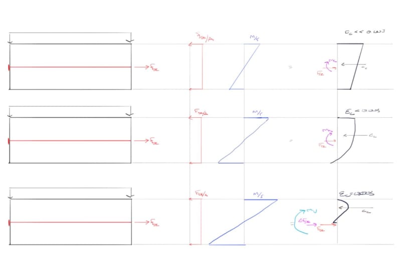

this is how I look at it following loading from service through to ultimate.
If Fse was reacted by restraint then in the service cases Cc would need to be counteracted by concrete tension in the absence of other mild steel and at the ultimate limit state Cc would only be counteracted by delta Fse. ULS would also be reached much sooner.

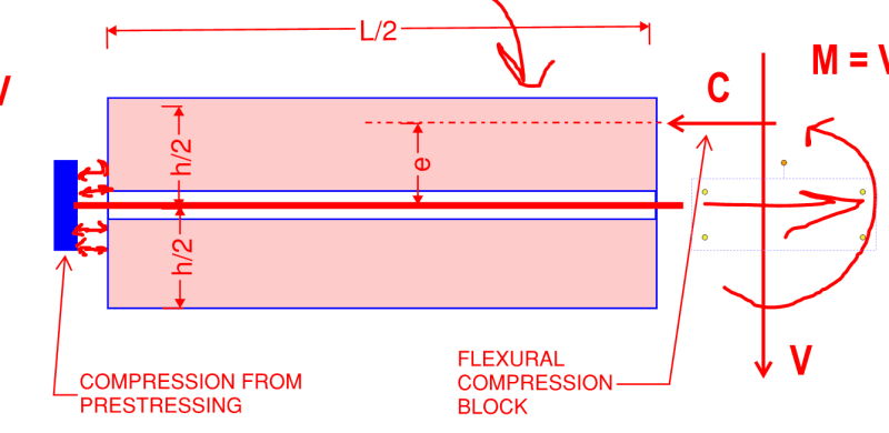

@Ingenuity: try this sketch on for size which, I think, echoes steveh49's comment. I'm not trying to be obtuse here but, rather, trying to find the particular way to present this that might get you onside with my perspective.
