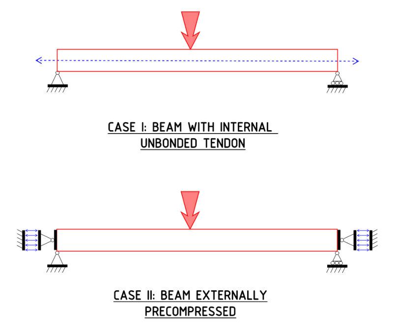

So for the following two cases they have the same ultimate moment capacity?
Usual qualifiers like:
(i) Span is sufficiently long enough that it is flexural behavior (no tied-arch for CASE I, no arching for CASE II)
(ii) Axial pre-compression is the same magnitude in both cases
(iii) Neglect area of PT and duct/sheath in CASE I
(iv) No buckling for CASE II
(v) No secondary effects for CASE II​
I would say yes, assuming that you've got some dead & live end anchorages in case 1 rather than the tendon just passing through to parts unknown.

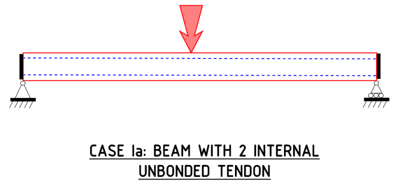

So similarly, for an intermediate CASE 1a (2 each no drape unbonded tendons, same total pre-compression at other 2 cases - see below) it too would have the same ultimate moment capacity?
Obviously not, since the tendon is eccentric from the centroid of the cross-section.
Stress = (M*y)/I + P/A = (M*(distance_of_tendon_to_centroid))/I + P/A (with appropriate and consistent sign rules)
In case 1a (figure in the previous post), y is nonzero, and thus the capacity affected by the sum of bending and compression action.
EDIT: Wrote this in a hurry, and noticed that ULS - not SLS - was the subject matter. Regarding SLS, the case 1a has only precompression, assuming that both tendons are at equal distance from N.A. (M/W term vanishes, due to opposite effects of the straight, eccentric tendons).

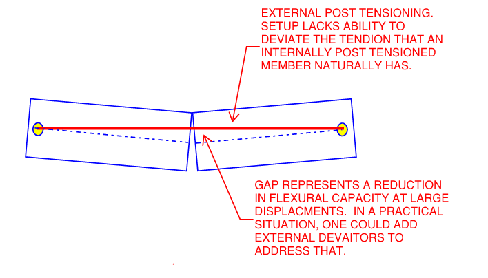

I disagree. I believe that case 2 two does have an ultimate capacity and that the primary things that it lacks are:
3) An ultimate capacity based on the yielding of composite reinforcement. But, then, that is true of all unbonded PT without the addition of bonded reinforcement.
4) The ability to deviate the tendons to match the displaced shape of the beam as shown in the sketch below. And that's really what I was getting at with this earlier statement:
KootK said:
In a ULS event taken to the extreme, where caternary-ish stuff starts to develop, yeah, there's a difference. However, to my knowledge, we don't normally consider that in ULS flexural design calculations.

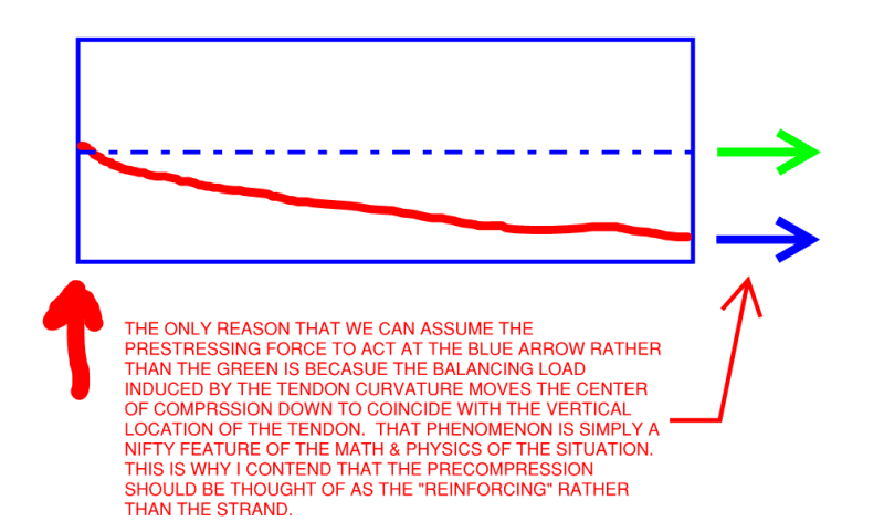

I feel that the italicized portion of that statement is incorrect in a fundamental way. As shown in the sketch below, I believe that an unbonded, post-tensioned beam with its anchorages at mid-depth derives its flexural capacity from two actions acting in concert:
1) The concentric pre-compression induced at the ends by the anchorages and;
2) The balancing force induced by the curvature of the tendons.
A member needs both of those things, acting in concert, to develop its full flexural capacity. If you remove the concentric pre-compression but keep the balancing forces, then the member will have some flexural capacity but, in most cases, not anything close to its full flexural capacity. That's what I was getting at with this statement:
KootK said:
1) Not quite as you've still got the load balancing effect of the tendon drape. The end product sort of resembles a suspension bridge rather than a prestressed concrete member though.
The balancing load contribution can be envisioned in at least two different ways with respect to its contribution to flexural capacity:
3) As a transverse, uplift force combined with a pre-compression force concentric with the anchorages (green arrow below) or;
4) As shifting the pre-compression force from the elevation of the anchorages to a location concentric with the pre-stressing tendons (blue arrow below).
Obviously, #4 is what we do in practice. The salient point here being that it's one approach or the other. Combining the balancing load with the effect of a deviated, unbonded tendon represents double dipping. Conversely, there's no way remove the pre-compression without sacrificing capacity.
Dialing things back to a more fundamental, Newtonian physics perspective where conservation generally rules: does anyone really think that we could remove the pre-compression effect from a prestressed member and not have that cost us something? I view that as being self evident with or without tendon drape.
