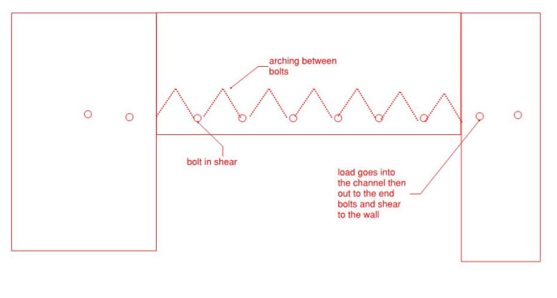

I have an existing CMU wall which is made of 8" block and assumed to be unreinforced. The wall is 17' tall and we want to create an opening that is 11' wide by 12' tall. I want to use 10" channels on each side of the block above the new opening. There will be through bolts connecting the the channels through the CMU. I need to determine the required size and spacing of the bolt steel. Has anybody used shear friction to carry the wall load to the channels? The idea is to leave a 3/4" gap between the channel and the CMU wall to be filled with grout, which would mean the block would have to slip out from between the channels, which would mean that the through bolts would have to elongate first.
Additionally, we do not want steel columns on either side of the opening. Has there been any consensus on using through bolts in bearing as an end reaction? If the shear friction concept above works for the span, could it also work for the end reaction?

To get a decent amount of shear friction, you need a rough surface, which the back of a steel channel is not, and you need a decent pretension force in the bolt, which is not really possible in hollow block. More likely you have bearing on the bolts and bending in the bolts inside the hollow CMU. I don't know of any literature out there which addresses this kind of bolt bending/bearing action. When I have to do something like this I use conservative assumptions and big bolts and channels.
More likely yet, is that the unreinforced CMU arches and/or spans on its own across the opening, without really activating the channels in bending. If think about how much the channels would flex for a given span, the wall probably would need to crack to deflect that much.

I think in practice you get shear on the bolts and arching action between the bolts. In that spirit, the bolt spacing is critical and smaller diameter at a tighter spacing is better.
But agreed, the angles have a simpler load path with direct bearing.
As GC notes... I think it is the arching action between bolts that causes this method to work. I would not rely on shear friction. I've use this approach for temporary 'needle beams' for supporting walls while cutting out masonry below and installing a steel W section lintel below. I've also use permanent steel C sections and welded them to permanent vertical C sections at the ends.

JLNG: I've also seen it done successfully but now I am trying to justify it with numbers. As far as friction, PCI (7th ed.) Table 5.3.1 has a μ of 0.7 for steel-to-concrete, I would use a value of 0.6 to take it conservative; we can also score the block horizontally with a grinder to increase that friction. To get the bolts tight we would place them on the end joint of a "stretcher block" so that there is a web immediately adjacent on either side of the through bolt. I'm not opposed to the stitch plate, but then my question that remains is bolt bearing at the end reaction.

sticksandtriangles: So are you saying that even with a fully grouted core, you only count on 2" of bolt bearing because the remainder of the bolt will not actually be in contact due to bending? If so, what are your thoughts on filling the drilled hole with epoxy before setting the bolt so that it is in full contact?
That's right, 2" of bolt bearing even in fully grouted construction; thought being either bolt bending or local crushing of the CMU/grout near the exterior of the CMU reduces the effective length bolt bearing.
I'm not sure the epoxy makes me feel any better about the local crushing concern or the bolt bending.
