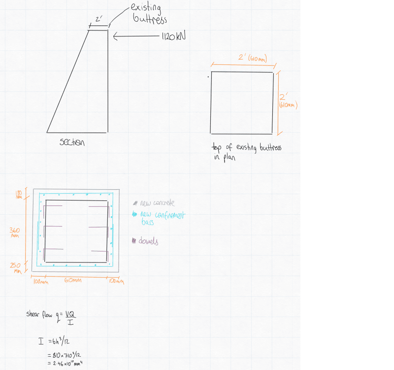

Good day, I need to reinforce a buttress at the top as it is damaged and there is also not enough shear capacity at the top to transfer the force to the lower portion of the buttress.
I would like to essentially jacket the existing buttress to increase the shear capacity and to transfer the force to the lower portion of the buttress. I do not want to jacket the entire column (plan to only go about 5' down from the top, the full height of the buttress is about 18'). I would just like to provide a jacket at the top to successfully transfer the force to the stronger part of the existing buttress.
I essentially would like to calculate how many dowels I need transfer this force.

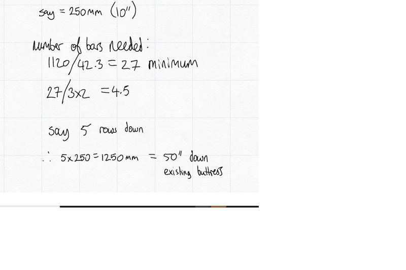

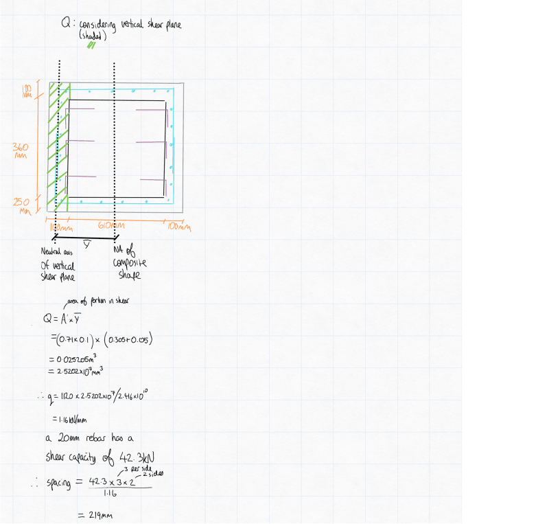

I haven't done a concrete jacketing calculation before but have done shear stud designs for steel beams. I’m not sure if I am approaching this the right way so any help would be appreciated.
See shear flow calculations below :

Rather than trying to form and dowel into the sloped face, I would be tempted to increase the depth at the top of the buttress by doweling into the back of it (on the vertical, flat face). If you want to stick with your idea, take a look at using the shear friction concept and installing vertical dowels into the top of the buttress.

My original sketch wasn't really clear on the sides I was dowelling into, so for clarity I was planning to dowel into the sides of the buttress as shown below.
Unfortunately, I can't really increase the depth of the flat vertical portion that I think you are referring to as it's essentially on a road and I can't reduce the road width.

Your shear stress calculation is only valid if the applied load is in the direction shown below:
It appears that your applied load is actually perpendicular to this. (If I'm understanding things correctly, the plan showing the dowels is rotated 90 degrees from the section/elevation that shows the taper.)

@ProgrammingPE Thanks you are right; I've actually changed the geometry around quite a bit (eg 203mm jacket all around instead of 100mm), and now that I am removing more of the wall and replacing it with new concrete, the cross-section at the 4' mark down is larger, which is resulting in a reduction in the shear dowels required per row or allowing for larger spacing. However, your comment is very helpful, as I initially was thinking that I can put the shear dowels through only the two faces as shown above, but it seems that the shear is acting in all planes and I need the shear flow reinforcement in all faces normal and parallel to the force. Now I need to figure out how to fit additional bars in to account for this.
