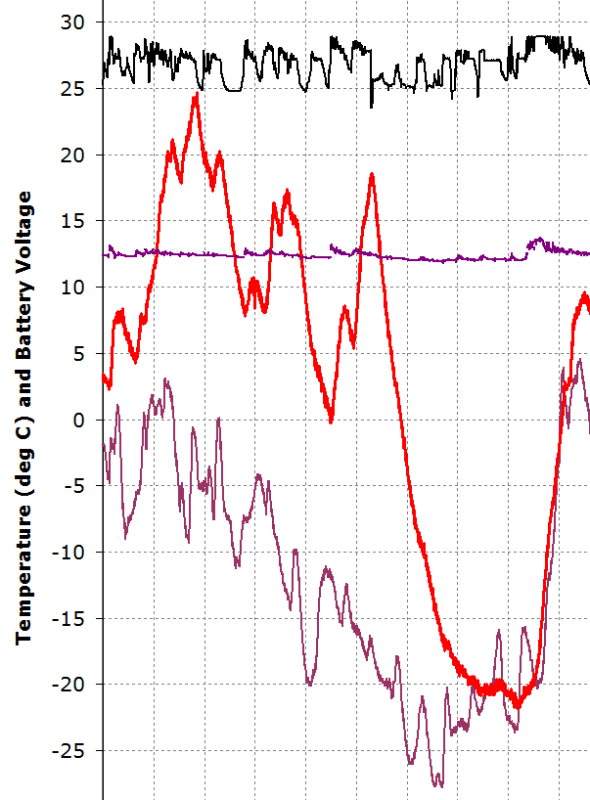

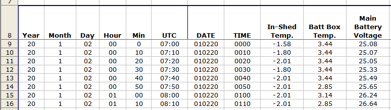

Umm, how about RS-232 with a 9-pin Dsub?
I use a 1990 vintage weather station logger to do this in 10-minute intervals. Internal memory can hold a year of data.
There are also a couple of other things monitored simultaneously like temperature inside and outside the enclosure.
I have some spare units in my garage. I would be happy to send you one. Happier to send you two.
Edit: Looks like CAT got you what you need already!
