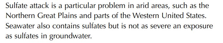

Here is what I found on PCA circa 2002. Not sure where you are located. Another resource is the local ACI or ready mix association.
