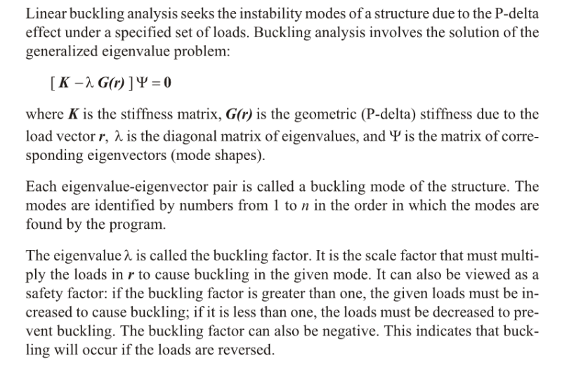

I don't think a linear buckling analysis will work the way you want it to. The CSI Analysis Reference Manual has the following to say on Linear Buckling Analysis:
That suggests that the way the program is solving for it is dependent on the current load vector. And, I don't see an obvious option for doing the type of Base Load + Variable Load * Buckling factor type of analysis.
You could certainly create a series of load cases where you use Base Load + 1.1*Variable, Base Load + 1.2*Variable Load ..... until you start converging on your buckle factor.
That's not a totally clean way to do it, but if you're stuck then it seems a realistic way to move forward.
Alternatively, you could try a nonlinear buckling analysis with large displacements to see if that gives you some more loading options. Or, a time history analysis where you Ramp up the variable load with time.
