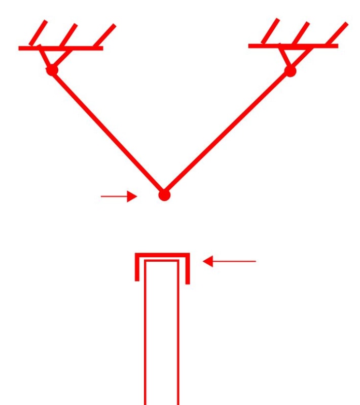

I would be concerned about the two details shown below. In both cases, the diagonal braces would have to buckle in order to allow the upper structure to deflect. It is better to confine the top of wall horizontally, but allow vertical deflection.
The detail shown below permits one inch of deflection before the braces start to buckle, that is, after the screws have been removed. If more deflection is required, the gap may be increased.
BA

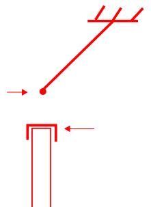

Are you suggesting a deep leg slip track at the top of the wall and doing the kicker up from that or are you just saying run the wall full height and do a slip track? Because I don't think the first thing actually braces the wall unless your kicker has a moment connection at its top end or is framed like some sort of frame with another stud kind of similar to the double angle triangle image. I have seen details like this on other engineer's drawings, but I don't think it actually works in theory.
Yes, a deep slip track. The system would function the same as the hand sketch given above. I am not sure why you would need a moment connection. One of the snips above shows splay wires which is definitely not a moment connection. Here is a Link to a bunch of CFS details. If you want to be fancy you can start adding clips with slotted holes at the connections and the slots will allow movement.

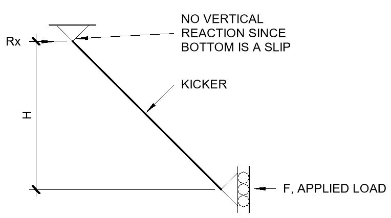

I think if you draw the FBD for that kicker, it doesn't actually work out per the image below.
In the last pic (by OP), there can be no force F, and no reaction Rx. So, there can be no force in the kicker.
BA

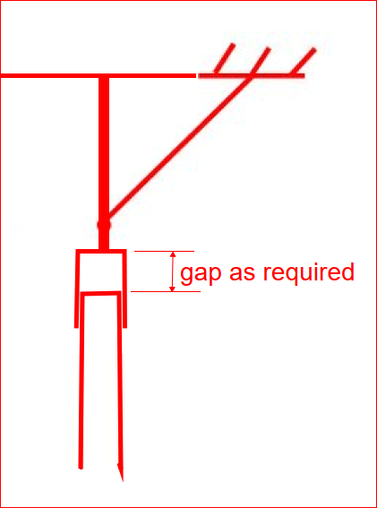

I modified the sketch of GC Hopi below:
The inverted bucket shape can be a continuous member, but more likely a short keeper assembly spaced along the partition to be laterally supported. The gap must be equal to or greater than the expected deflection of the structure above. The connection to the roof structure must be rigid to prevent the keeper assembly from rotating.
BA
BARetired said:
What is automatically incorrect about the one before this comment? I think the FBD would be stable.
How does the lateral force get from the channel to the hinge? You didn't show a connection between them.
BA
Ah, I figured a connection between those elements was implied. Carry on.
It's not implied. If it's a vertical member hinged top and bottom, the assembly is unstable.
If it's a vertical member hinged on top and rigidly connected to the channel, deflection of the roof will be transmitted to the partition.
