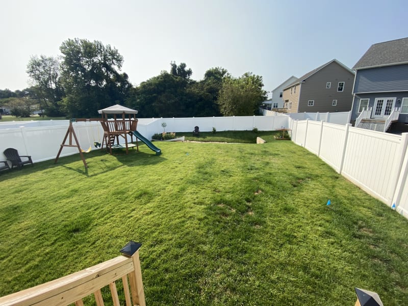

We've been notified by the county to a fence running along the property line and going over a drainage way is too low. We are planning on raising however the constraints provided by the county seem a bit excessive.
The fence has 1 post in the middle of the ditch. The county is asking that the post be removed and two posts on either side of the ditch placed so that fencing can go over the ditch. However they are requesting that the bottom of the fence be 1.5 FEET above the bottom of the ditch. Water levels are never this high and this seems excessive. We are not happy as 1.5 feet will make a massive gap in their backyard and dogs can easily escape.
Are these requirements normal for fencing over a drainage ditch?

Attached is the picture of the current layout.
I'd like to just raise it up enough to meet the 18" requirement while not creating 16 feet of gap that needs to be remedied to keep dogs and or children from climbing out.
The red line is what the county is suggesting, which seems ridiculous. The black lines a proposal to avoid creating that massive gap to be filled. This is directly in the back yard ~25 feet from the house.
Thoughts?

I guess its really closer to 35 or so. Attached is the picture of the entire yard. The area in question is on the back left.
Flowing left to right?
Is that a culvert on the right?
Why not extend the culvert?
Correct. Left to Right. I would have loved the culvert to run the entire width. Don't know why it wasn't. I was advised by the county the 10 year storm is suppose to be grass...

Do a Google search for "fencing across a ditch" and look at the images. This particular page is just one of many that will come up and I am highlighting it because is has some good examples of fencing extensions into the flow channel that will maintain perimeter security and permit channel flow to pass through:
Some agencies require a completely obstruction-free channel under the fence and some allow (possibly require?) a grate like the one EdStainless mentioned or even a full trashrack. However, if the agency can't provide you with the actual requirement, how are supposed to comply? Could it be that they have do not have written requirement and are trying to fake it? If so, then you probably aren't required to comply with a non-existent requirement.
However, the fence in your photo is certainly a bad design and something needs to be done, so it may not be worth it to push back. A better approach might be to suggest a solution that deals with both competing interests: channel hydraulics vs. site perimeter security. Since perimeter security is important, I would prefer to raise the bottom of the fence, then install some sort of chain link fencing to the bottom of the channel, or a trashrack, etc.

blocking the waterway with anything, including the wrought iron fence/grate you show in your link is liable to cause flooding on adjacent properties. this is likely to result in a legal claim/lawsuit against you for cause. any sort of blockage that can clog with debris is probably not acceptable. suggest a second fence to keep the dogs in the yard is a better option.
Thank you CVG. Good to know. Only reason I even am thinking of doing it is because the Civil Engineer Contact at the County suggested it. Perhaps a small white picket fence etc. really is the best way to go.
