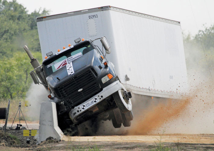

looking for a detail for a jersey barrier with chain link fence attached on top. I know this is common but I cannot find a good detail.

That fence is likely to become a projectile if a truck hits the barrier.

I'd understood that the profiled side was to 'redirect' the vehicle back on to the roadway. Is this correct, anyone?
Racing circuit barriers work differently to normal road barriers. The cars are much lighter, much much lower down and the aim is to keep them and their components on the race track and not in the crowd.
Any angle at the speed these cars hit them on a race track could result in vertical motion which is not what it wanted.
On a highway the wheels will deflect / deform first then the body will impact higher up.
So race track - flat side, highway - angled side.
