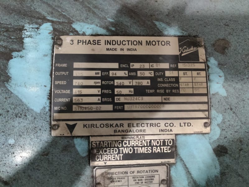

Currently using 335 KW 3 Phase Inductor motor (415V 563A 740 RPM) without any VFD in Hot Rolling Mill.
Thinking about investing in VFD to drive the above motor to enjoy saving due to VFD.
The motor operates in 20%-50% load for 50% percent of time. The current peaks up to 800-900 A for 1 seconds or less in every 10 seconds. Motor starting current is controlled via resistance shorting of slip Rings. (Motor runs idle-No load for atleast 20min in an hour)
My Question is -
1.) Whether VFD will be able to help in energy saving??
2.) I have decided a VFD (ABB Manufactured) rated for 600A. Will it be able to momentarily (less than 1 second) supply 800-900A during over loads???? What will happen in overload? will it Stop or Slow the process???
Attached the current reading during Normal operation.
Thanks in advance!!!!!!!!!
This is a big investment, I just want to be sure whether it worth it or just a marketing gimmick.

It is unlikely that a 600A drive will accept the parameters to successfully drive a 900A motor, even intermittently loaded. You might get a better answer by providing label plate information.
Rated motor current is 563AMP. Attached name plate below​

To answer your question, a typical VFD, sized for a "constant torque" application, will be capable of an overload of 150% of its rating for 60 seconds, 200% for 2-3 seconds (depending on design and brand). That rating however does not take into account how long of a "dwell time" you have in repeating / cyclical loading applications. The drive needs a certain amount of time to dissipate the heat away from the transistors, and that becomes a more complex equation determined by the VFD design, so best responded to by the manufacturer of the drive itself..
But that said, I caution you that rolling mills, although a good candidate for VFD control to improve operational control and consistency, are highly complex load profiles that need experienced applications engineering to be successful. And if the only goal is to "save energy", then it is a folly. The only way to save energy with a VFD is to reduce WASTED energy and in a centrifugal load like a pump or fan, that is accomplished by taking advantage of the "affinity law" of speed in those machines. But in a rolling mill, that does not apply. The work done, and thereby the energy consumed, by the motor is based on the load and throughput. Although you may be able to realize a change in the CURRENT, that is not the same as ENERGY, it is a COMPONENT of energy. When you are seeing the spikes in current now, that is where your product enters the rollers, slows the motor, increases the slip, which pulls more current to generate torque but also lowers the power factor as well. So the current increase is a COMBINATION of the active and reactive current. The actual ENERGY is represented by the work done, an that is determined by the load. The VFD will not change the amount of work done, so the energy consumed will be the same (minus a few percent losses in the VFD itself). Again, there may be other very valid reasons to use VFD control on rolling mills and it is done all the time, but "energy savings" is not one of those reasons.
1) For VFD, motor shall also be suitable for VFD application so you have to check whether the existing motor can be run with VFD, VFD Motor Shall have Dual Coated Copper VPI Insulation, Insulated bearing at NDE, & shall be suitable for dv/dt 1.3kV in 0.1 µs.
2) the present configuration with SR Motor and LRS having low starting current about 2 times of rated and high starting torque about 2.5 times of rated. it also give smooth start.
3) how you are planning for power saving are you looking to stop the motor during the ideal hrs. I don't seen any other mean of power saving with VFD in your application .
4) what is current trend with this application check with supplier if they in there new supplies using combination of SC Motor and VFD or still using the SR and LRS combination.
5) you can find VFD in market suitable for overload per your requirement, only thing you have to de-rate the VFD which in tern cause higher cost.

I have now decided NOT to invest in VFD drive as it won't result in much energy saving as per above discussion.
If you want some energy savings, and since you already have the Wound Rotor motor and controller, you could look into what waross was mentioning, called a “slip recovery system”. It’s essentially a VFD put onto the rotor circuit to capture the water heat energy in the rotor (rather than have it heating up your electrolyte in the LRS) and putting it back into your grid. They typically pay for themselves in 2 years or so, depending on your electricity costs. Several reputable companies make them, I believe Toshiba is one of them. I used one from a company here in the US called Flomatcher, but if you are not in North America, I’m not sure what their support is like. But here’s a site on their system that describes it.
I don't believe a slip energy recovery system will save enough energy to pay for itself if it's just used to accelerate the motor to full speed.
