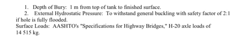

Dear LittleInch,
The nonuniform pressure is due to a load on top of the terrain in which the vessel is buried.
I’m kind of confused because usually the concrete and such above the tank withhold the forces, but in this case, they want the tank to withhold the above ground forces.
I have read briefly EEMUA PUB 190, and it can very well be used to calculate the loads, but i’m failing to understand how i should interpret them for a double skin storage tank.
Only thing I can think of (i dont know if it can work) is if i assumed this load as a uniform pressure from lets say -alpha to + alpha, and then treat it as per ASME VIII, and if it’s below the critical pressure of the outer skin, then it can hold it. Please any feedback would help.
Detailing is a hobby,
Also attached is a picture of the specification for any remarks.
You might check some of the references for underground piping, AWWA M11, for example, where this is a common loading.
