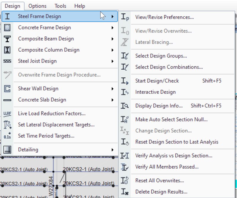

Most of the steel "connection design" is still done in ETABS. I'm talking about code checks to AISC 341 or 358, panel zone, stiffener checks et cetera.
If prequalified connection design per AISC 358 is a part of ETABS, that's a big deal, but I couldn't find that either.

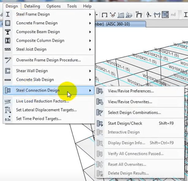

It seems that connection design (other than limited checks per AISC 341 & 358) has been removed from the program and 3rd party programs (or SCM table lookups or other methods) need to be used for typical shear connections and moment connection design. Saying 'most' isn't really acknowledging that this was removed, I do appreciate the quick response.

The menu used to look like this
Now looks like this without steel connection design, and there are no connection design options under 'steel frame design'
