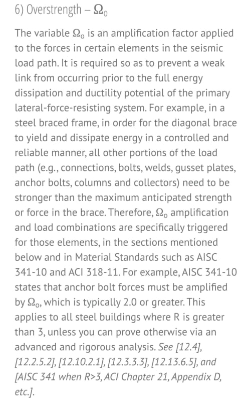

Not clear when this needs to be applied. I mainly deal with 1 and 2 story single family residences, SDC = C or D.
Here's the link to above screenshot..
For your type of structure, assuming wood construction, omega is mostly going to appear in the design of any beams supporting shear walls and restraining their tiedowns. See ASCE 7-16 Commentary Figure C12.3-5
Also any custom concrete anchorage associated with seismic loads. Most of the time we use test products but occasionally a special condition comes up that requires us to design the anchorage.
