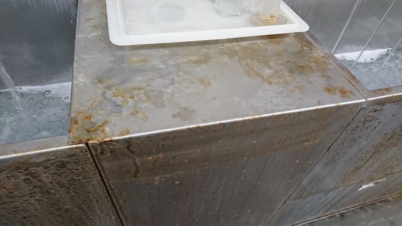

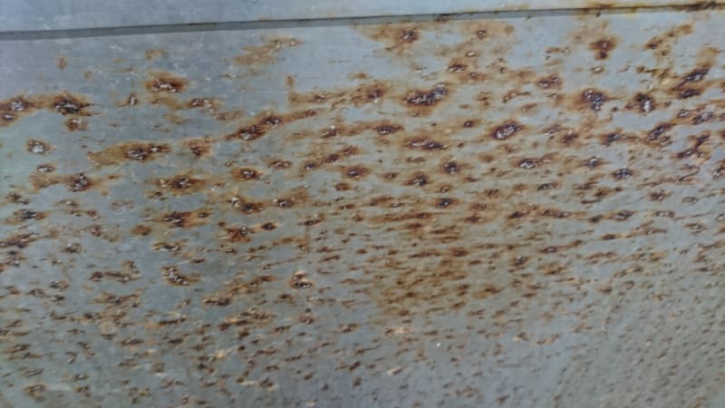

Does anyone have an explanation for this corrosion?

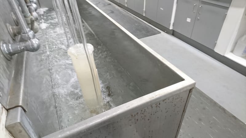

This application is a remodel of a water treatment laboratory. The equipment is all new. The trough sampling sinks are made from Gauge 316L-2B stainless steel. The other items like the drawer pulls and safety eyewash are 316 stainless steel.
The trough sinks are used for water quality control and the water runs continuously. The trough sinks have the worst corrosion. As you move farther away in the room, the corrosion on the other fixtures lessems.
October 2020, photos were taken of new rusting stainless-steel products in the Control Lab. New stainless-steel eyewashes, new stainless-steel tub sink, and new stainless-steel cabinet handles were all showing significant signs of rust.
March 8th – 10th, 2021 the new stainless steel trough sinks were installed and were not cleaned or polished at that time. Within a week, these items began showing signs of
rusting.
On April 5th, 2021, the new stainless steel trough sinks were cleaned and polished along with other existing stainless-steel products. Within a week, they began showing signs of rusting again.
On May 27th, 2021, Owner polished the new stainless-steel trough sinks. Within a week, they began showing signs of rusting again and photos of the current condition of the new stainless steel trough sinks are included.

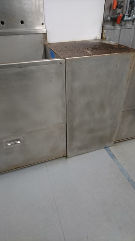

The laboratory was remodeled. The stainless steel backsplash was 50 years old and the reused backsplash is not rusting.

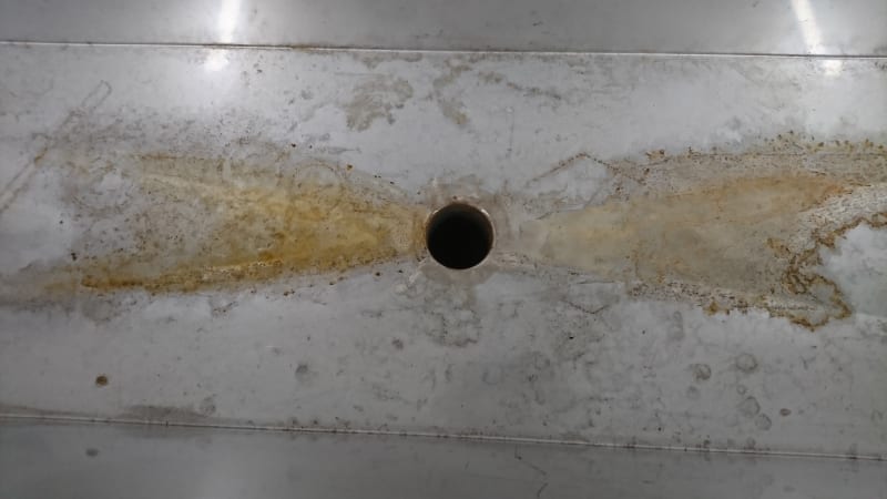

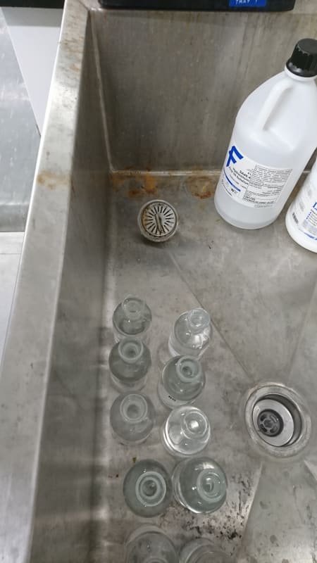

The inside of the trough sink is not exhibiting rust like the outside.

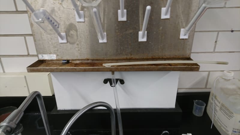

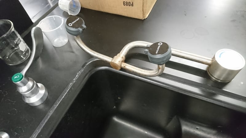

The other components (eye wash, faucet, and hood) are 316 and also show rust, but not as bad as the trough sink.

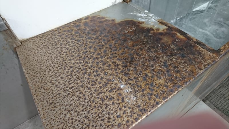

I suspect that in production (or more likely fabrication) iron (steel) has been embedded in the surface of this material.

The lab supervisor stated that the previous sinks were all some type of stainless steel and didn't exhibit the corrosion stains. As stated previously, the stainless steel backsplashes haven't been changed nor the faucets. Don't know why the trough sinks were changed.
Do you think that this equipment can be saved or is it recommended to propose non-metallic sinks? The trough sinks with the worst corrosion are used as just potable water sampling with no other reagents used. 70% of the inside of the sinks have no corrosion. The worst corrosion is on the outside. It looks like the splashing water may be evaporating leaving salts behind or the splashed surface is absorbing corrosive fumes from the lab. The lab does clean glassware with HCl but not in these trough sinks. The lab uses other chemicals such as sulfuric acid.

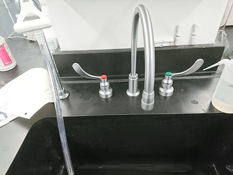

The lab supervisor stated that the previous sinks were all some type of stainless steel and didn't exhibit the corrosion stains. As stated previously, the stainless steel backsplashes haven't been changed nor the faucets. Don't know why the trough sinks were changed. For the most part, the backsplash and faucets do not have extensive corrosion, but do have some water scale on them.

If your corrosion were concentrated around the welded areas I would suspect carbide precipitation and that would likely require replacing the equipment. This does not seem to be your case. In 2 of your pictures there appears to be blisters of rust which indicates pitting so you may want to replace those pieces (only if they fail again after cleaning).
The acid cleaning an be done online, the process takes minutes. Just work small areas at a time. This will minimize the fumes produced. Ventilation and respirators will allow workers to be in the space during the cleaning process. The gel type cleaners can be applied by brush and may help facilitate online cleaning. The same gel cleaners can be used to touch up future corrosion areas that may arise.
