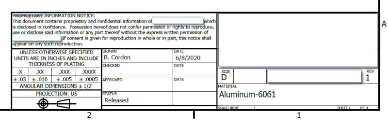

Good Afternoon
I have a question regarding hole callouts
for a threaded hole with a counterbore where does the depth of the thread start
Is it from the top surface or from the bottom surface of the counterbore
Thanks in advance
What drawing standard is called for on the drawing? Under ASME Y14.5 they are all measured from the top surface. Not sure about ISO.
I would read this as from the CB surface.

so in the case mentioned, the tapped hole is 0.355" deeper than the bottom of the CB
I don't see a dwg standard on the drawing
i thought it was the top surface..... this is a manufacturer of plasma machines..... i thought i remember it being top surface when i was doing aerospace parts...but not sure
I'd block out the company name. Per ASME Y14.5, users of the standard are required to specify the specification number and year suffix in order to be applicable. If it isn't there - it's random as to what anything might mean.
ok, someone dug up the answer for you, and now you say "but that standard isn't called up". ok, cool, quite correct. but there is a standard for describing the situation.
If you're unsure if the standard applies, why not ask the people who drew the drawing what they meant ?

Also... [2] minor issues...
1. In the title Block There is a statement 'PROJECTIONS: US" … which implies US drafting practices [in SI units]… which typically points-to ASME Y14.100 [and all sub-practices].
2. Also, wearing my aero-materials 'hat'... "Material: Aluminum 6061" … is an extremely vague description that could lead to MANY problems.
I HOPE Your material specification actually 'reads' more like this [my long-version]...
Material: 6061-T6 or -T651, plate, ASTM B209 or AMS4027 or QQ-A-250/11
Raw Stock Size: XX.xx-ST [as-rolled-thickness... or specify acceptable thickness range 'a.xx-to-b.xx'] X YY.yy-LT [plate-width, minimum] X ZZ.zz-L [plate-length/grain, minimum]
Just saying...
Regards, Wil Taylor
o Trust - But Verify!

Drawn a year ago and not checked, approved or released yet?
Are you making the parts? Send the drawing back.
Are you tasked with finally checking the drawing?
The resulting "measured from the top" thread engagement of 9 mm/ .355 inch/ 1.8 Diameters is probably OK strength wise, but I would want more with steel fasteners in aluminum.
Regardless I would want someone involved in the design to double check all mating components including fastener length.
