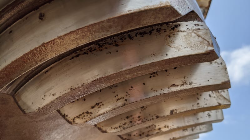

Are there any tips or guides for qualifying gears for use after corrosion? I have a palloid gear set that spent a short time immersed in salt water and has bloomed a bit.
'a bit' may not be a problem.. I'd expect you would want to disassemble the gearset, remove any corrosion present, refinish the gears as necessary to provide the right tooth surface finish, characterize any dimensional losses as a result of that process, and then determine if they are suitable for continued service.
This of course may not be possible, if you can't afford the downtime, can't disassemble the gearset, or whatever other issues may arise.
If this is a set which is very low load, you may be able to just run them and let the gears 'descale' themselves on mating surfaces. Much depends on your application.

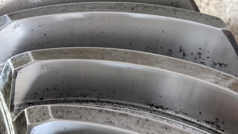

We are hand buffing to clean with nylon mesh abrasive. This pic is before any cleaning. Pic is not the best due to back light. To me, the corrosion is similar to corrective pitting but I don't know if corrosion causes other issues. All bearings are being replaced, they were much worse off.
Some specifics about the application are 2500 horsepower at 250 rpm through ~3.5:1.

Fortunately, most of the surface was unaffected other than the pits. This is the worst of it here.
It's quite a large gear and permanently assembled on its shaft.
wow, yes no clearance for hob/mill rotary cutter or grinding, pitting is bad news, but it's a beefy gear
It looks like a cyclo-palloid gear, so it can't be ground. It can be hard-finished though. It all depends on how deep these pittings are and if there are any sharp corners that can serve as stress concentrators. In such case I would have them re-finished by manufacturer until these marks are 100% gone. If too much stock would have to be removed and the case gets thin - they are scrap. Otherwise these gears can fail anytime. I wish all the news was good, but this is what I think.

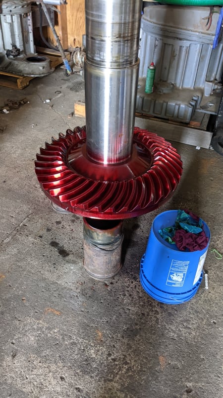

May I ask what that nice red gear marking compound that you are using is?
Spot check, dye penetrant. Checking for cracks as this gear experienced some load transients that resulted in the sea water exposure (boat went aground).
