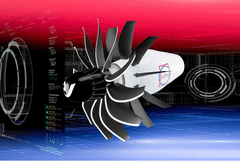

Ahhh... the Ultrahigh By-Pass Un-Ducted Fan engines... lovingly known as the 'screamers'.
That's my recollection why they didn't catch on at the time.
Flight tests of the UDF has been put on hold because of the fact that acoustic pressure was so high that cracks has started build up in the FTB's fuselage structure almost instantly. This is why GE inside assessment for this was "no go" for the direct drive fan type. Right now what is worked with Safran this is geared version - from practical standpoint this is just large turboprop with fancy looking fixed-pitch propeller. I think reducing blades number and adding PCM will be next step (just matter of time and xxx mln of USD)- this way GE/Safran will close the loop and will reach conclusion that turboprop is most efficient form of turbine propulsion (kind of discovery isn't it?).
really ? a fixed pitch prop ? didn't they go out in the '30s ?
yes - simply is spinning much faster than standard propeller but still slower than original UDF- if you have seen pictures they have added additional fixed blades behind propeller for tuning down noise - child of CFD analysis :D
those blades look variable pitch ?
If the blades spin faster than normal turboprop, are the tips supersonic ??
