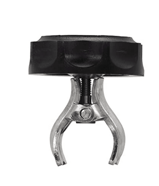

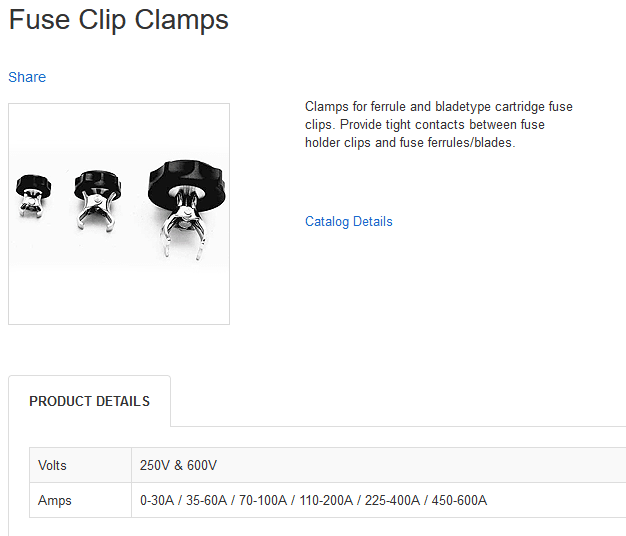

Many years ago I worked in a plant with fused disconnects in all of the MCC buckets.
We found that the fuse holders tended to lose tension and start to run hot.
These helped a lot with weak fuse holders.
Bussman NO.7 Tron Clip Clamp:
Range of Sizes
