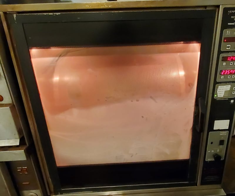

I have a bean roasting application where there's a perforated rotating horizontal stainless steel drum in an oven.
Max temp is 375°F (200C)
We're trying to get the temperature of the roasting contents as it tumbles in the drum.

How is the drum or oven heated?

3phase CALRODs 230V 33A

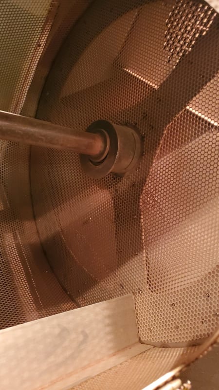

Does the drum shaft have to go completely through the drum? Could the end bearings not be cantilevered? If they could, there is an easy path through the non-driven end by making the shaft hollow, and passing a fixed (non rotating) probe through that end. It may get beaten up by rotating into/out of the beans as they tumble...but maybe if the probe is built stoutly enough it could hold up.

into a hollow shaft for the drum, then down the shaft and outside the oven to a place that is cool or can be cooled
I think this is where we'll have to go. Currently one end of the shaft is gear driven and very technical to get through, like center drilling the 90 degree gearbox shaft. But the non-driven side, while solid, isn't doing much of anything. I think that can be re-tooled to make the center hollow allowing a completely non-rotating solution to present itself.

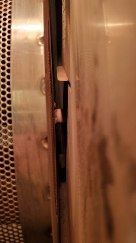

Yay the hollow shaft angle. That's where this looks like it's going. You saying "cantilevered" made me think of actually sitting one end of the drum on two bearings so there is nothing going on with the axle at all. It could be a 4 inch hole! The beans can't get up to the axis ever... hmmm.

Bearings on the ends which had been the chicken rotisserie support system providing three chicken shafts. The drums are custom designed and made so they could be changed. I'm hoping only one exists at this time.

Forget my other suggestions. I am tending towards the hollow shaft solution.

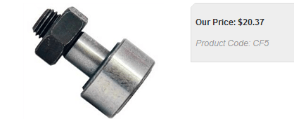

How about replacing the NDE shaft with a 4" stainless pipe centered and supported by three cam followers?
