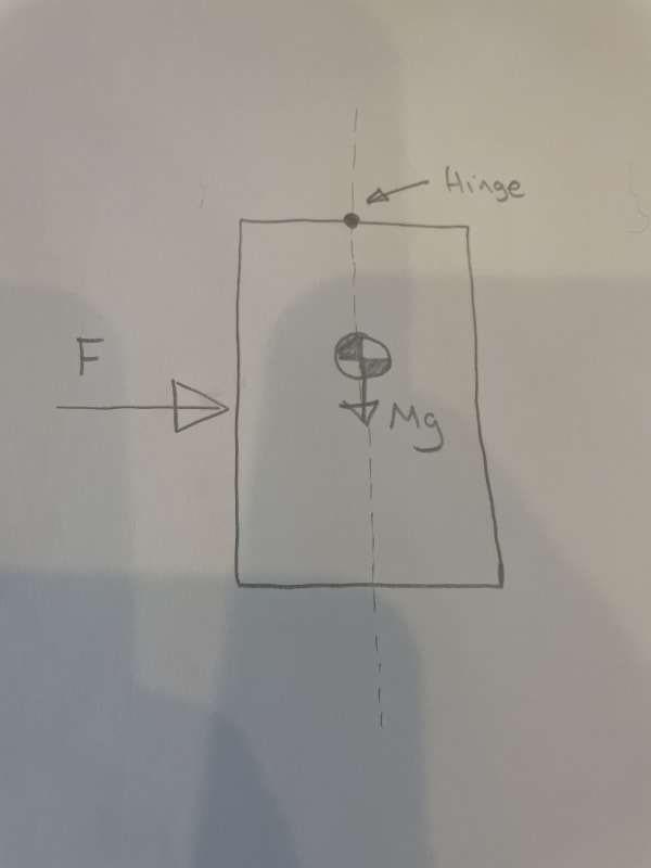

What would be the best way to calculate how far this object would rotate if a force acted on it for 3-seconds only?

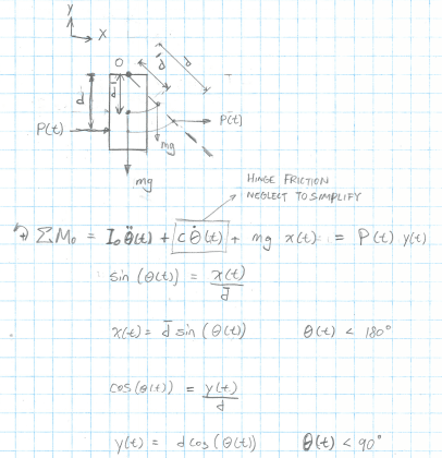

My first thought after looking at this for 5 minutes is that this is a Single DOF dynamic equilibrium system.
Instead of springs and dampers, you would have (mg)*y(t) as a restoring force, with y(t) as a function of the rotation.
Edit: After looking at this a bit more, if the force is assumed to parallel to the x-axis, below is what I think the equilibrium equation will be. If the theta is small, you may be able to simplify and get rid of the sin and cos terms. The trick is to integrate the equation to get theta(t), but this can probably be done numerically (i.e. Newmark-beta method).
Can you just use the displacement formula (Delta = 1/2*a*t^2 = 1/2*(F/M)*t^2) and then treat the distance as an arc length to get the rotation (Theta = Delta/radius)?
(I'm sure there's more to this that is not being accounted for like the polar moment of inertia of the plate and friction in the hinge. Also, does gravity act against the applied force once it rotates 90 degrees?)

I assume the force is applied tangential to the rotation .

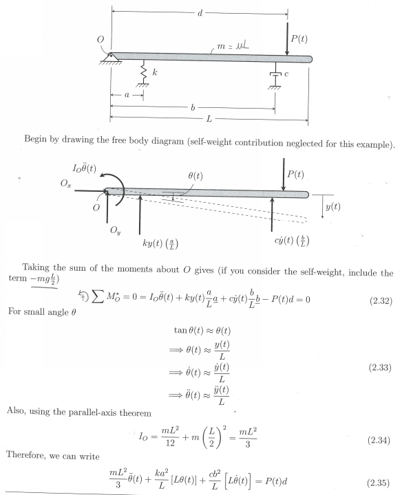

I'd follow klbridge's post, eqn 2.32 (as modified by his last comment). and note y(t) = R*theta(t), where R is the CG position.
Would need to know if the force remains in the same direction or rotates with the mass.
Three seconds is plenty of time to justify using statics. Then, the problem is easy.

Would anybody care to explain the numerical integration required for kwlbridge's method? I learned Newmarks years ago, but can't quite remember how to get started for a specific equation above. I do have a nice step by step procedure to solve the general equation of motion, but unclear how the rotational nature of the problem changes the various k hat, p hat, a, and b formulas

What are the values of F, M, and the dimensions?
Assuming F does not follow a curved path (i.e. h is constant)
For equilibrium, F*h = W*e, so F = W*e/h
F = force at distance h below the pin.
W = weight of block = Mg
e = eccentricity after a long time (3 seconds is a long time)

BA, maybe you're right. A big point of doing this calculation is to prove you're wrong though.. I don't think 3-sec's is enough to reach a significant portion of the max displacement.
Tomfh, see below:
[ul]
[li]Force=1500 lbf (always perpendicular to axis)[/li][/ul][ul]
[li]Weight:100,000 lbf[/li][/ul][ul]
[li]The weight and lateral force act at the same point, 60 ft from the rotation[/li][/ul][ul]
[li]length of rod is 120 ft[/li][/ul]
