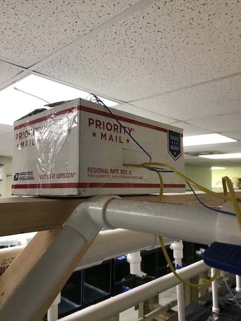

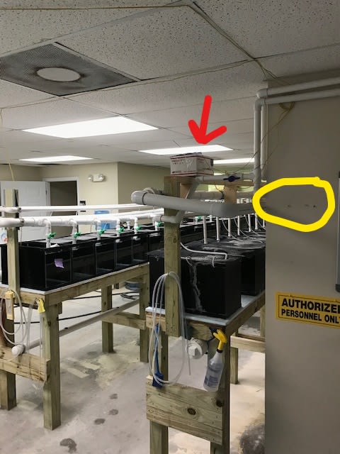

I have insulated the logger in a cardboard box with packing paper. The box isn't large, but if insufficient ambient temperature compensation is the culprit, I should at least get a reduction in the noise, if not outright removal, correct?
See pictures of the system below.
All water is saltwater (marine aquariums). The thermocouple ends in water have been insulated with hot glue, applied by myself.
Thermologger in insulated box. The end of thermocouple #4 is on top of the box, measuring ambient air:
The current location of the box (red arrow) vs where the datalogger used to hang on the wall (yellow circle). Note the AC vent about the area:

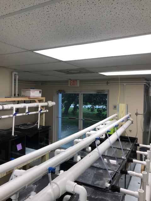

Another angle:

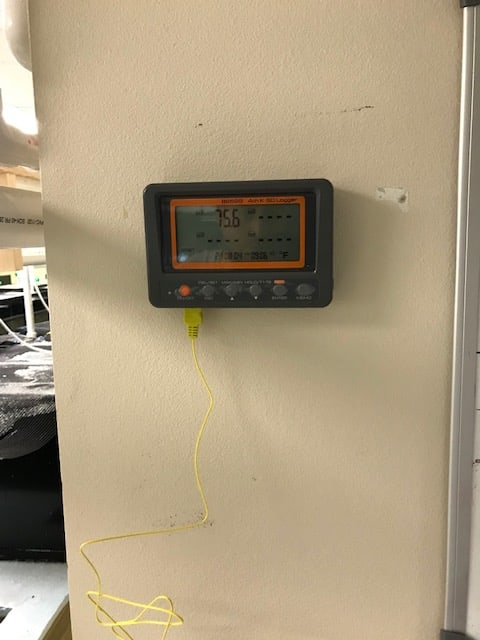

The how the thermologger used to hang on the wall. Note this picture only shows 1 attached thermocouple, but the current logger in the box has all 4 thermocouples attached.

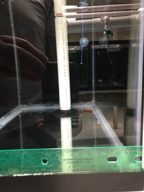

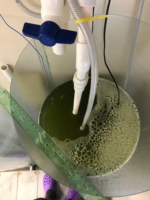

End of thermocouple #1 in a 10 gallon tank:
End of thermocouple #2, also in a 10 gallon tank:
End of thermocouple #3, in a 200L tank:

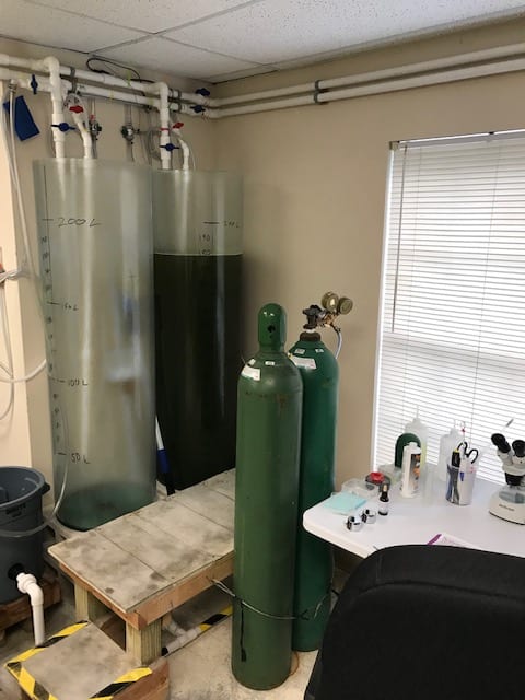

Wide view of the 200L tank and surroundings:

Ocellaris; Outstanding. This should be educational, thanks for following thru. Looks good. That A/C vent and the position of the logger are dead-ringers for Bill's theory.

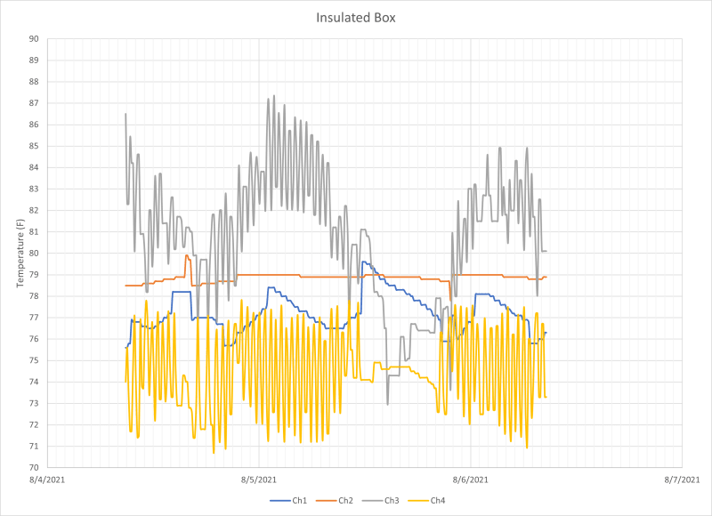

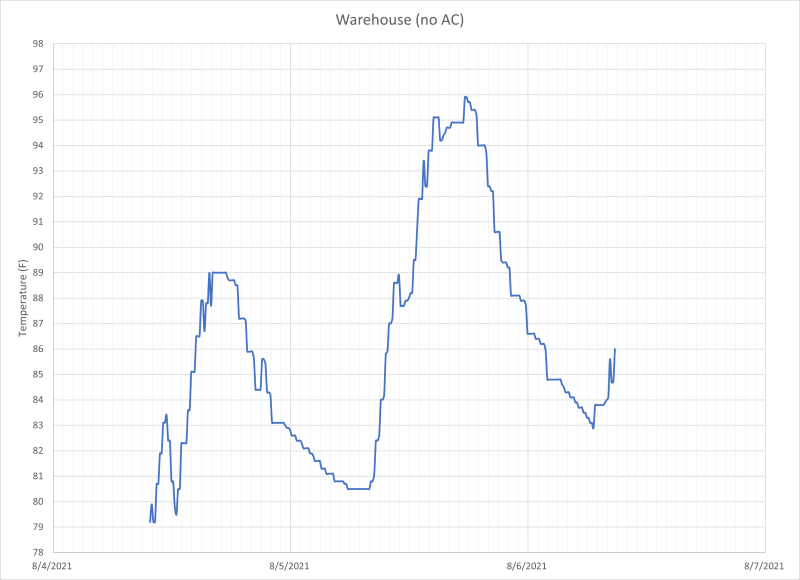

I recorded some new data with the setup shown in my previous post. Unfortunately, the box did not remove the noise.
I also recorded some data using an identical datalogger in an un-air-conditioned warehouse, and compared it to the original data from the air-conditioned office (original post). There was no noise in the warehouse data.
It seems that the AC cycling is the problem, but the insulation that I used was insufficient. Does the entire length of every thermocouple need to be insulated?

Thermocouple #1: A K-type extension wire with the end stripped and twisted together, then covered with hot glue. In a 10-gallon tank.
Thermocouple #2: A K-type thermocouple, end covered in hot glue. In a 10-gallon tank.
Thermocouple #3: A K-type thermocouple, spliced with extension wire (for length), end covered in hot glue. In a 200-liter tank.
Thermocouple #4: A K-type thermocouple, end covered in hot glue. Measuring room temperature.

Also, the noise seemed to get worse for channels 3 and 4 after insulating the logger (the chart scales below are identical for easy comparison). Thoughts?
Edit: Now that I think of it, it might have just been a hotter series of days outside.

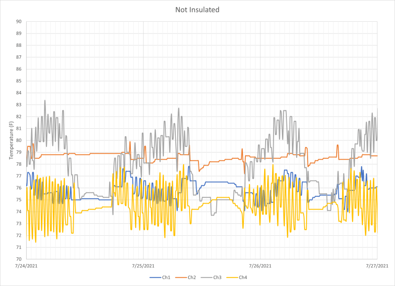

Shown below are the results for:
1) Original water tanks/room temp setup with uninsulated datalogger.
2) The same setup with the insulated box, pictured in my previous post.
3) Room temperature sitting on an office desk in an air-conditioned room.
4) Room temperature in an un-air-conditioned warehouse.
1) Original uninsulated setup
2) Insulated setup
3) Air-conditioned office
4) Un-air-conditioned warehouse
