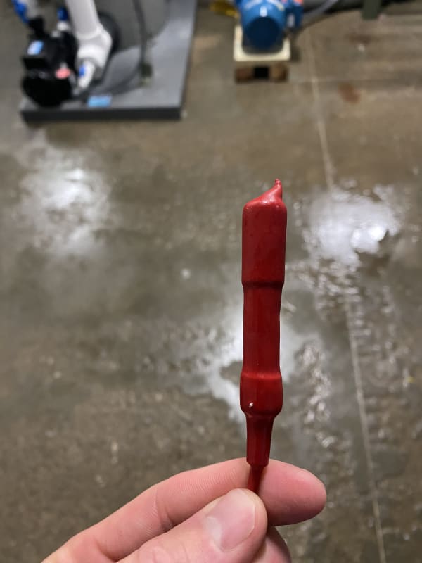

I believe you're talking about the grey wire with the red end? I'm not sure what the red is, but it looks like tape or heat shrink which might not be that good at sealing and insulating what's inside from the outside.
I would expect to use something more like this for an industrial type of use.
Unfortunately, I'm stuck using the type of probe, otherwise I would try something else. I plugged in another probe I had and got the same results. I would be surprised if they are both defective. Also, I've used these probes elsewhere on site and not had this issue.
Here is a close up, it's seems like they dip it in some kind of rubber

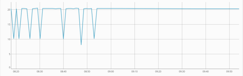

For some extra info, this is how things look when the VFD is off but the probe is still in the water
What is the sampling rate. Those are remarkably linear changes and look more like it's undersampled and there is a high-resistance short circuit somewhere, though the one spike down is farther than the rest, so it's not helpfully constant.

But interesting to see the rubber coating suggests an attempt to exclude moisture. But looking at the first post photo it looks like the probe is submerged past the level of the rubber so that the grey cable (twisted shielded pair instrument cable I think) is also submerged. That would defeat the waterproofing of the rubber I'd suspect you may have potential point for water entry into the circuit either at the interface or maybe even through the grey cable. That could also potentially explain why you only see the problem when the probe is submerged (although tbh I'd think if moisture got in the problem would not go away as soon as you remove from the liquid... it might take awhile to dry).
Can you hold the probe higher in the liquid so only the rubber part is submerged? (that would help prevent moisture entry if it's happening).

>this is how things look when the VFD is off but the probe is still in the water (chart 3 posts up from here).
So when the VFD is off you still see downspikes as shown on the left side of the chart, 8:20 through 8:55, correct?
Observation: Sampling rate - Looking carefully between 8:40 and 8:50 you can see that it's one sample per minute.

@Electricpete - the probe is made by avtech, they don't have the exact ones listed on the website as these are slightly customized. I have the same probe elsewhere, in other systems, fully submerged in water and don't have this issue. I can certainly try having the probe higher up in the water column.
@Danw2, Apologies I wasn't very clear, the down spikes occurred when the VFD was on, the straight line is after it is turned off. I should have annotated the graph! The data collector is line powered, but can run off an internal battery. I don't have another temp sensor I can try at the moment. Temp sensor and data collector is an Avtech. The system is for growing fish! Thus the reason for so much sch40 pvc.

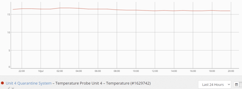

As a comparison, this is the graph produced by the same type of probe, submerged in the same way, in another system. The only difference is, there isn't a VFD in the room with the probe.
