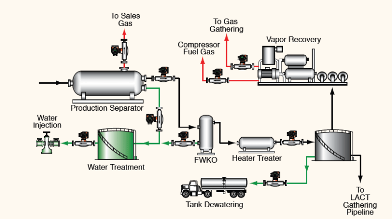

Trying to calculate total pressure/flow numbers for a well that is producing 7 mmscfd gas, 2000 bbld water, 600 bbld oil. All will be seperated and sent to an oil tank, water tank, and gas line. I know that my gas output line needs to be 200 psi. Trying to calculate the inlet pressure that will go into a separator so that I can size it. Calculating for a temp of 60 deg and against standard pressure. Just not exactly sure how to add/account for all gas, oil, and water volumes/pressures coming out of well. Thanks

Thank you for the response. Right now the distance from well to separator isn't something that needs to be considered just because of where we are in the design. The gas composition isnt important either because this is just the first phase of separation between oil gas and water. I do not know the pressure at the well head when it is flowing with these values, thats what I am confused on and need to find. The gas temp is lets say 120 and liquid is 60. As far as pressures go, really the only thing that is "known" at this point is that the gas tie in (output) line is 200 psi.
You should get the well pressure at max and when flowing ASAP. You're kind of stuck without that.
Gas design pressure makes a big difference in equipment size. Temperature too, but not so much. The higher the pressure, the smaller the equipment. 1000 psi design will half the size of a 500 psig design. 500 psig design pressure will be roughly half the size of a 250 psig separator. 200 half the size of 100 psig. If pressure can be higher than 200, you could then let pressure down before going to the gas pipeline. Large differences in size occur at lower design pressures, so design pressure is kind of really important.
You could assume 200 design pressure, but that might wind up being 2x or more as big as you will need in the end.
If the well is too low pressure, you may even need a field compressor to get into the gas line.
Come back as soon as you know the well pressures and temperature, or otherwise determine the separator design P & T.

Thank you all for the responses! So assuming the design pressure is 200 psi, and lets say gas and liquid each take up 50% of the volume coming from the well and going into the separator. What are next steps in sizing/designing the separator process and piping size. Looking at using either a high pressure 2 phase separator followed by a heated 3 phase lower pressure separator OR a single 3 phase heated separator which would have to buy high pressure. Thoughts?
I did some calculations using the design pressure and volume flow rates that I have coming out of the well. I was getting somewhere around 12 ft/s of gas flow with a 12 inch pipe when pumping against standard pressures
Again, this is still pretty early in the design process. The goal of this part of the process is to do first stage seperation, the seperated oil, gas, and water will be transported in trucks to another facility for further treating. I know there are some unknowns but im really just needing to get more of a broad preliminary design done at this point with the values given.
Maybe this helps
