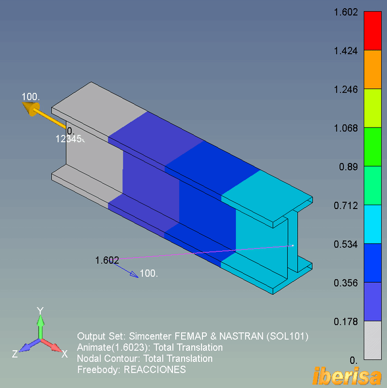

I have decided to use RBE3 to apply some loads to a beam. Singularity fatal error does occur, though I think I have selected the "right" DOFs in both the dependent and independent terms of the RBE3. In fact, all translations that define rigid body motion have been activated on the independent node, as well as all possible DOFs related to moments that should develop.
The model is attached to this post. It is a cantilever beam loaded on its tip using the RBE3.

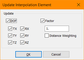

Dear Matty,
In fact, your RBE3 is singular, is the message of nastran, you need to constraint ALL your DOF in the INDEPENDENT node to get working.
The most common user error in RBE3 element specification results from placing 4, 5, or 6 in the Ci (independent DOF) field in addition to the translation components. The rotations of the dependent point are fully defined by the translational motion of the independent points. The ability to input 4, 5, or 6 in the Ci field is only for special applications, such as when all of the connected points are colinear.
In summary, the intended use of the RBE3 element is to transmit forces and moments from a reference point to several non-colinear points. The rotation components 4, 5, and 6 should be placed in the Ci field only for special cases, such as when the independent points are colinear.
This way you will arrive to a solution:
