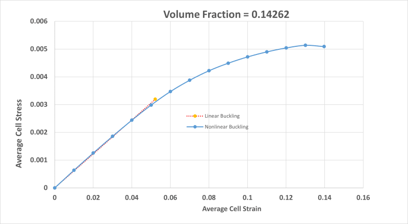

I did extensive work on the unit cells where I find the youngs modulus, bulk moduli, degree of isotropy, buckling and yield strength. I then modelled two [3x3x3] structures of these unit cells where instead of using linear material model I use hyperelastic material model and enabled geometric nonlinearities in my FEA model.
Due to time limitations I cant do as much work on the [3x3x3] structure, but I did a bunch of linear and nonlinear analyses where the models are fixed on one side, and compressed with a displacement load. What I have are many curves similar to the one below; the blue curve is the average stress/strain data for the nonlinear buckling, and red dotted line with yellow point is the buckling stress and strain value at which it buckles in my linear model. I have this kind of curve for varying thicknesses (volume fractions). So I can see how the data changes as the thickness of the walls in the model changes. Any suggestions on what I could do with all these stress strain curves for many different model thicknesses?
Edit: Forgot to mention that the unit cell is supposed to represent the smallest piece of a structure that goes on infinitely, so it would be surrounded by similar unit cells on all sides and therefore the boundary conditions would differ of the [3x3x3] structure that is only fixed on one side.
Well, compare these curves for different models (volume fractions). Put them in a single plot and analyze relations between them. Formulate conclusions, e.g. "The higher the volume fraction, the higher/lower the critical buckling load" and so on. Comment the post-buckling behavior (from nonlinear buckling analyses) as well. Also, highlight the differences between linear and nonlinear analyses (whether the linear simulation overpredicts or underpredicts critical load).

What was the purpose for the original analysis? Doesn't all the data you have answer a question or help in solving a problem?
