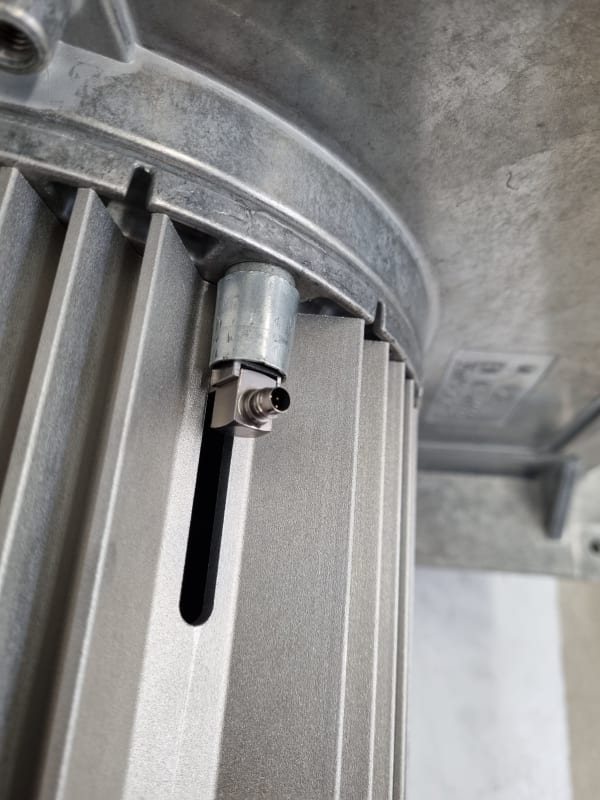

I'm having some trouble coming up with a good idea on how to make a quick mounting for a sensor. For every part that is beeing checked the sensor is mounted on screw head (DIN912). On one side of the screw head there is just few mm space (just for better understanding).
This is the senzor: (SYTRAN 3023A2 S/N 9847)
And this is the current design:
Current design is made with a magnet and this mounting part. The problem is that is not fixed hard enough and it rocks to much during testing.
Does anybody has any idea how could i make a fast mounting of the sensor on the screw head? I thought about a more powerful magnet but I'm not to keen on this idea. Maybe some sort of a
clamping sleeve?
Thank you guys in advance!

I now talked with our programmer to realise what the problem with current design was. As I said the problem was too much shaking of the sensor. When we used a clamp (that is seen in the above picture) the shaking was OK but there was conductivity between parts. So one part should probably be made out of plastic?

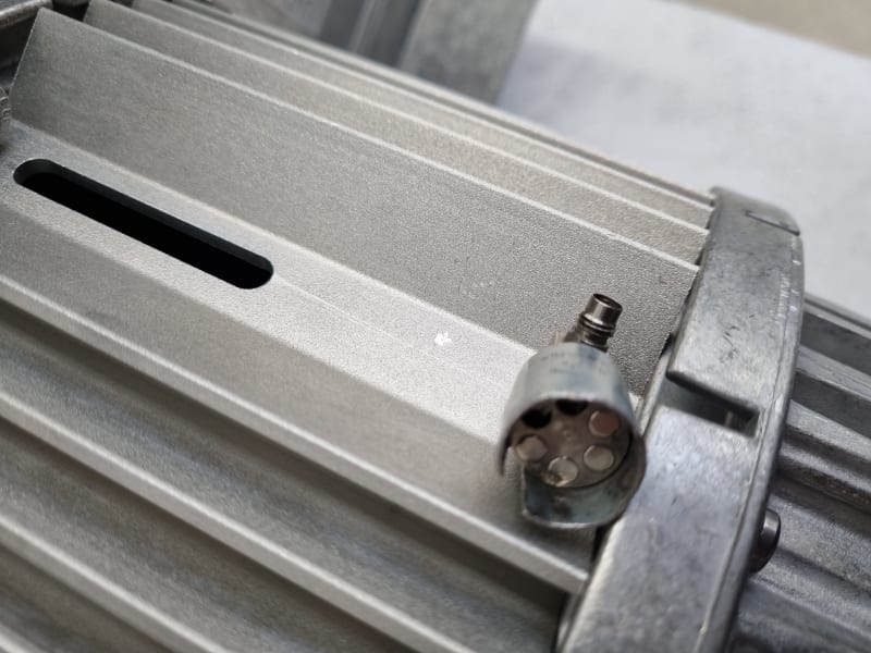

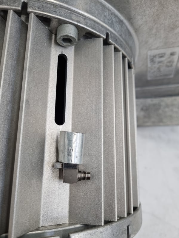

I'm attaching some more pictures for better understanding.
I thought about making one part plastic and otherwise making the same design. Does anybody have any better ideas?
What if you machined or 3D printed a sleeve similar to what you show above and then epoxy neodymium magnets into place. It looks like you already have some magnets in use. Also, is there some way to make use of the slot to mechanically fasten the sensor in place?

Do the magnets alternate polarity? Are they set into something non-magnetic? Is there a steel (magnetic) backing? Are the faces of the magnets flat within <0.001"? Has the bolt that you are mounting to had the top surface ground flat?
I don't like exposed magnet mounts because they are fragile and I can generate more force by using pole pieces.
There is no reason for this mount to more than 0.5" thick.

The mounting must be controlled for axis orientation and for frequency response. The magnet looks unusual (nonstandard or OEM stock) and was probably designed for a specific mounting situation, and not the way you are using it in the photos.
Typical mounting methods include using a metal disk base with stud attachment to accelerometer and with base attached to a flat surface with various adhesives. I have used petrowax, hot-melt glue sticks, 2-part epoxy, epoxy putty, dental cement, and super glue.
Avoid using a plastic base unless measuring only low frequencies and temperature is low.
