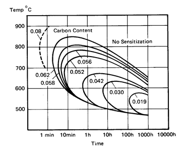

is there any standard, code, or reference for Permitted temperature for bending 304 Stainless Round Bar?
in the below thread has been mentioned that temp. should not go above 800F, is there a reference for this temp.?
thread367-249230
Above 800F you begin to run the risk of chrome carbide formation in grain boundaries (sensitization).
This is a common figure in virtually any SS reference.
While the graph infers that for low carbon material you can tolerate some time at higher temperatures, this assumes that the material was properly and fully solution annealed first (which usually isn't the case).
Much depends upon the actual carbon content. 304 can be 0.04%C and it can be 0.08%C; there is a massive difference in sensitization risk between those. The TTT diagram shows that Carbon below 0.030% gives effective immunity during normal thermal operations like welding.
But, if there is any even a microscopic trace of Cr-C in the GB then you can cut the times in that graph by a factor of 100 or more. The reason is that that graph is based on the time to nucleation and growth to a certain extent. If there is even a trace of carbide still there from being under annealed at the mill (always) then you straight into the growth phase.
I have had 0.025% C material that would sensitize if you looked at it wrong because the mill anneal was crap. It would pass an A262 from the mill, but it wasn't truly solution annealed.
We used to tell people to limit it to 600F (assuming that they would push to 650F) and then you can be comfortable.

There isn't really one. If you stay below risk of sensitization then you get almost not stress relief effect.
If material has been well annealed and is low C (<0.025%) I have resorted to using 1000F for 20min to get some strain relief, it is enough to reduce the magnetic signature and restore some ductility.
These are meta-stable alloys, though mostly austenitic but when strained they will have some transformation to martensite (no C but BCC) this greatly lowers ductility and makes them somewhat magnetic.
The only real fix for this is to go back to solution anneal (1950F) and rapidly cool (which causes stresses of its own).
