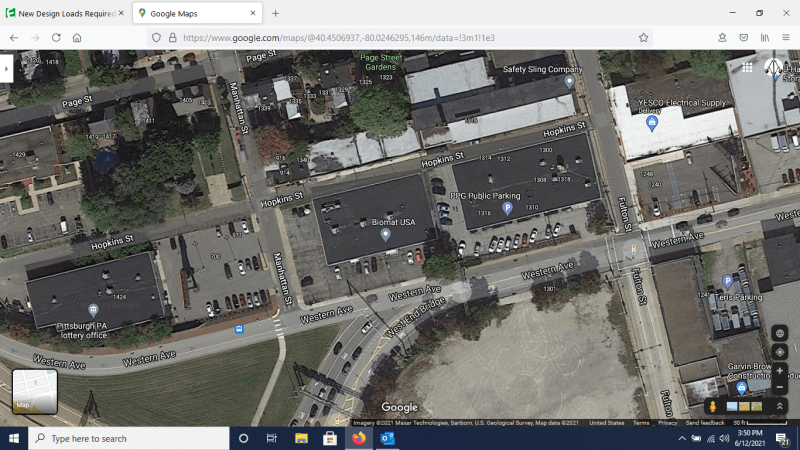

wonder if the car's path was from that ramp

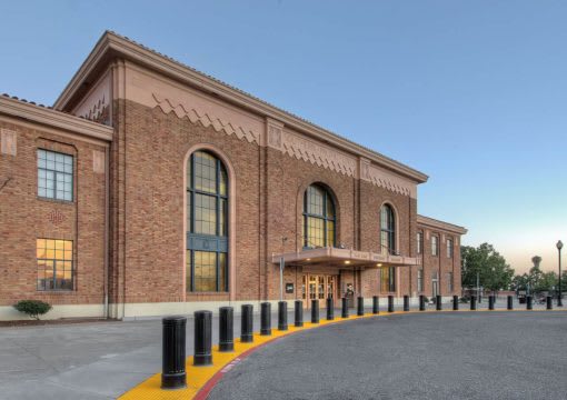

Considering the use of bollards, higher GFL etc ..could be options..
IMO, a security an safety assessment study is necessary rather than changing the design loads..

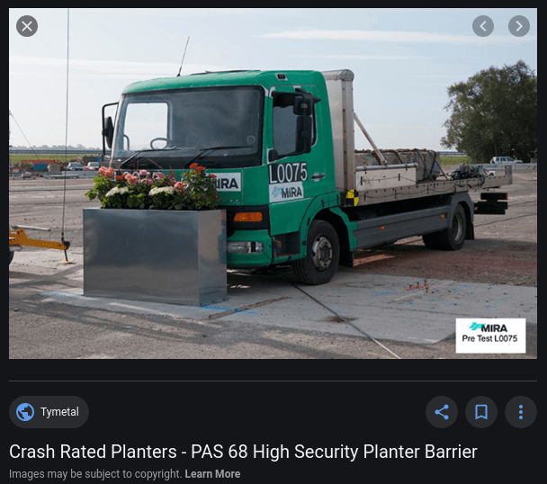

Nothing reasonable would stop that. Bollards like that would just launch the vehicle up in the air.
Several tons of crash rated planters might slow things down a bit. 100 MPH however is a lot of energy.

At least good bollards would have stopped the subframe and you would have just had the sheet metal body hitting the building.
The SUV was coming down off of the bridge ramp and failed to make the turn.
It looks like the building is only about 60' wide, and they made it nearly clear through.

100mph does not sound a vehicle out of control. A set of effective bollards will force somebody to use different attack strategies, like charging in to the building with a semi-automatic rifle or pistol. If the bollards can top a two ton SUV, you can always hijack a big truck.

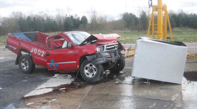

A 2 tonne vehicle doing 160 kmh is ~2 megajoule. There are plenty of interesting bollard products out there that will stop that level of attack.
This bad boy will do 30 tonnes at 80kmh. That's 7.4 megajoule.
