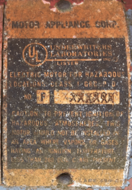

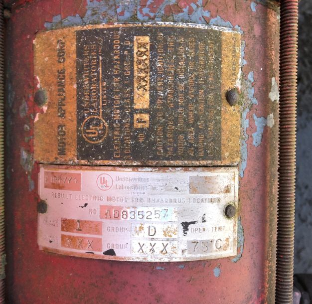

I need to replace an electric motor that is currently installed in a hazardous location (classified) area. The data plate reads as a Class1 Group D motor. The "division" designation is not on the data plate. Picture of motor and data plate is attached. Should I just assume DivI and just be done with this?

Class 1 = vapors
Division 1 = always present
Division 2 = infrequently present.
Group D = Things like propane.
Either order a motor suitable for division 1 (conservative), or verify the area classification with the process engineer.

Old motor nameplates, I believe, were Div 1 capable (going by memory, so double check me on that). However, as described previously, check w/ your process engineer to ensure Group D is still applicable. Often-times in the plant where I worked, process chemicals were changed routinely and motor specifications had to be carefully coordinated and at times, motors changed out to meet new process requirements.
The question(s) I'd ask is: "where is the motor being installed and is it near an equipment material opening, such as a process dryer outlet or the like?"

I would assume Division 1. Per NEC, if the area is designated Class I, Div 2, ordinary squirrel-cage motors can be used. If the motor has commutators, sliding contacts, etc, it has to be listed for Div 1, even in Div 2 location. So it would be rare to see a motor labeled Class 1, Div 2.
But more importantly, someone has to decide on the proper classification for the area, regardless of what the existing motor is.
'Rebuilt' tag have anything to do with the xxx'ing?
There are two lines with class and group. Only the second line is crossed out, probably indicating that the motor is only rated for one class and group.
UL said:
Electric motor for hazardous
locations class 1 group D
No F xxxxxx
Caution to prevent ignition of
hazardous atmospheres this
motor should not be installed in
an area where vapors or gases
having an ignition temperature
less than 280 deg C are present
