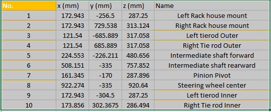

additional unwanted initial angle in steering system in adams model
Fariborz90808888
Automotive
Apr 28, 2021
36
IR
hi
i have changed the steering column joint from hooke to convel and i'm getting an additional 0.5 degree initial steering angle in every test...
can anyone help me with this?
what is causing ths?
thanks everyone for helping a lot
Probably your UJ phasing. Look at your plot of steering ratio vs SWA. You'll need to run it with lots of steps. you'll probably see the error there. How many UJS have you got in the column?
Cheers
Greg Locock
Thanks Greg Locock for responding
i haven't used UJs i have used convel joints...
how can i change the joint phasing??? i have used 2 convel joints in the steering column...
here is my steering column hp:
Yes but when you had Hookes there may have been a problem with the phasing, which the CVs have eliminated. Your tie rod inners aren't symmetrical so you'll get a bit of a difference from that.
Cheers
Greg Locock
hi Greg Locock
i have used symmetrical coordinates for the tie rods and i still get 0.39 deg initial steering wheel angle...
couldn't it be from the driver? or the unsymmetry of the whole vehicle?
thanks for helping me a lot in this forum
in a step steer test i see an almost constant 0.37 deg steering wheel angle ... that's what i call initial steering wheel angle...
