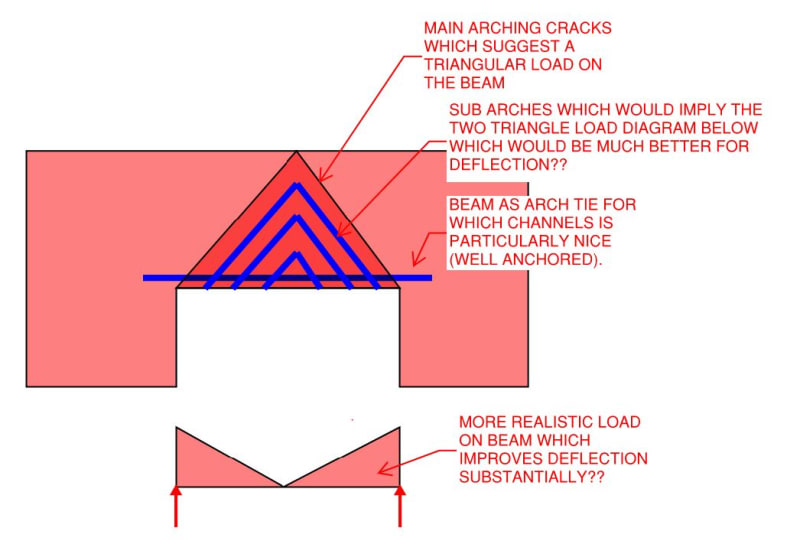

Juat curious, what span/deflection ratio do y'all design for when installing a beam under old masonry? Seems it would have to be stiff AF for it to actually keep the masonry from cracking. My suspicion is that the beams end up being there as a safety measure and the masonry just spans the distance in most cases.
XR - I usually shoot for L/600...but I agree. Considering the number of openings I've seen cut in masonry with no perceptible problems in the first 10-15 years, over modest sized openings the masonry will arch over and then the stuff below the "arch" hangs from the mortar. The beam ends up acting as catch when the mortar does final start to fail in tension. at 10' clear opening I'd start to get a little more cautious with it, though.
I'm in the L/600 camp as well with a maximum of 3/4"
I agree with L/600 approach. As KootK suggested, the channels should be stiffer than required which shall make the deflection negligible. Considering 60° load triangle over the 10 feet opening, the dead load from self weight of wall is not that high. 2-C300 (C12) should take care of it.
I have also provided a detailed procedure before when doing this so the support sequence is known. I included needle beams the last time I did this but it may not be necessary with the double channels, unless you want the bottom plate installed prior to loading the channels.
I typically go L/1200 on old masonry and L/600 on green masonry.
I've been doing L/600 with a 3/8" absolute limit. It's tough because it feels like any deflection would likely cause cracking. In this sense, pham's take on it is probably the pragmatic reality.
Per the sketch below, I've also had some heretical thoughts regarding what the real loading on such a beam really is in these situations. Any takers??
I just wrote out a response to refute you, but I can't do it. I think you may be on to something. As long as the masonry is in good condition, it does seem logical. The beam can only deflect if you have cracks in the masonry - otherwise the masonry is just holding itself up. Once it cracks, the load will distribute based on the characteristics of the masonry (arching action) and the stiffness of the lintel (stiffer toward bearing).
I think this is limited to forensics and answering "why hasn't that collapsed yet?" sort of questions. Unless it makes the design really stupid, I usually design for the full rectangular load - what if your nice new opening begets a vertical crack? If it's new construction, what if the architect throws in an expansion joint at that door without saying anything?
