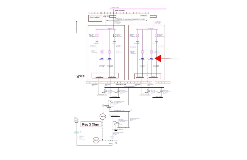

That is the situation I'm looking at that made me ask the question. We've open bus on the secondary side of a large transformer that is protected by the primary side relay only. They want to know what is the arc flash at the open bus? It depends, default to 2-seconds it's still high, but not off the charts like it would be if it were based on the relay settings.

We have two identical lineups 12' apart: Transformer -> open ac bus -> open AC to DC conversion equipment. Neither is ever worked hot. But when one lineup is down for maintenance - the other one is still hot. The question is - what is the arc flash hazard boundary due to the hot equipment?
I approached this as an arc flash at the hot equipment and tried to determine that and the decreasing intensities the further away from the open bus you get - up to about 8'. That might not be the right way to think about this. And this situation might not be an arc flash problem. It would take a screw up or a catastrophic event to cause an arc flash on one of these open skids. They are surrounded by Plexiglas.
There is another identical skid 12' to the right of this skid. This skid for example would be dead during maintenance - but the next one over will not be.

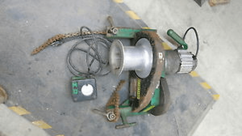

I was with a crew installing a new switch section in an underground sub-station.
There were open 12kV bus everywhere across the ceiling and on the walls, but the work area was well protected by plexiglass screens, (we thought).
The crew was pulling a3,600,00 CM cable into an underground duct with a tugger when the chain drive on the tugger broke.
The pull rope tension spun the capstain backwards and the chain doubled up and smashed the aluminum chain guard.
There were pieces of aluminum and broken chain flying everywhere, not just in the protected area.
Fortunately none of the open buses were shorted.
It could easily have been very different.
It is possible that some sort of accident or breakage at the worksite may cause material to be projected into the hor area.
I applaud your due diligence in considering the possible arc flash of an adjacent section.
Thinks will probably never go wrong, but if they do the crew will be safer due to your foresight.
