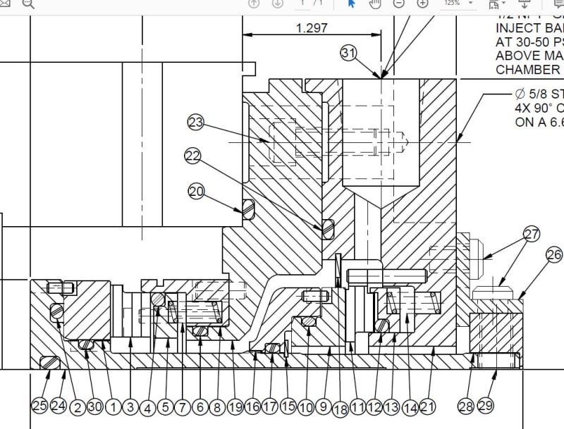

Dear All
We are facing problem of repeated premature Mechanical Seal Failures on 03 Multi Stage Centrifugal Pumps in our Refinery. The Problem is since commissioning and Seal manufacturer has done some modifications but problem has not been resolved.
While comparing Seal Arrangement on all Pumps in this Refinery as well as another similar/twin Refinery, I have found that the 03 problematic Pumps have 3CW-FF Seal Arrangement. All other Pressurized Seals in both Refineries are 3 CW-FB or 3CW-BB.
Another observation in addition to the subject 03 Pumps, another Pump in same Refinery had 3CW-FF Seal which suffered repeated failures and was latter modified to 3CW-BB by Seal manufacturer
I have gone through API-682 and what I understand is that 3CW-FB is preferred arrangement for Pressurized Double Seals. I appreciate if someone can explain the positives and negatives of these arrangements
Many people on this site may not be familiar with these coded designations. For their sake, I will try to clarify. All of these seals are contacting wet (CW) seals of Category 3 (high temperature) set up as pressurized double seals. The last two letters designate if the configuration is Face to Face (FF), Face to Back (FB) or Back to Back (BB). Please correct me if I have misinterpreted this.
There are a few differences that come to mind to distinguish between these arrangements. Without a seal drawing, I will have to make some assumptions. Depending on the pressure balance of the seals, there can be a big difference in how they react if the pressure between the seals is lost. The face to back arrangement is what some of us old-timers would have called a tandem arrangement. This can be pressure balanced such that the seal continues to function as a double seal even on loss of barrier fluid pressure. Leakage would have to make it past both seals to leak to atmosphere. The face to face or back to back arrangements might function as a single seal on loss of barrier fluid pressure since one or the other seal could not function under reverse pressure. One set of seal faces would be forced open by the reverse pressure. This can have a large impact on safety depending on your service.
There is also a difference based on where the potentially dirty product contacts the inner seal and whether the seals are stationary flexible elements or rotating flexible elements. If the dirty product in on the inside diameter of a rotating seal, any solids present can be centrifuged outward plugging the seal up. For dirty service, it would usually be preferred to use a stationary flexible element or to have the dirty product on the outside of the seal.
Any sort of drawing of the face to face seals that have been failing would be helpful. A description of a typical service would also help.

Dear Jhonny
Thanks for reply. Seal Cross Section is attached. Will u plz also help me understand how 3CW-BB & 3CW-FF compare. Our experience is that 3CW-BB are running acceptable whereas we are having problems mostly with 3CW-FF. In fact as I mentioned in one of Pumps Seal manufacturer has changed Seal Design from 3CW-FF to 3CW-BB
 https://files.engineering.com/getfile.aspx?folder=9d6a2031-60e2-4078-b059-a777f483b244&file=Untitled.jpg
The face to face drawing you provided has the pumped product on the inside diameter of the inner seal. Both seals are stationary bellows with normal outside diameter pressure. The fact that the mating ring on the inner seal is retained suggests that the inner seal is balanced for some amount of reverse pressure. The stationary bellows design is good from the standpoint of seal chamber face run-out. A stationary bellows will not have to flex with each shaft rotation and will be less likely to fatigue and crack at the bellows core.
But, even though the inner bellows is not rotating, it can still pack up with solids from the spinning shaft throwing them outward. The faces on that inner seal look like a very aggressive pressure balance in order to allow for loss of barrier fluid pressure without those inner seal faces blowing wide open. This balance probably creates some compromise in terms of face loading when the seal is running normally with full barrier fluid pressure.
If all they did was reverse the parts to make this a back-to-back design, then it would become a rotating bellows on both the inner and outer seal. This is bad for accommodating seal chamber face run-out. And, the likelihood of solids getting driven into the convolutions of the bellows by centrifugal force would be worse. If the seals are running better that way then the failures are probably not related to solids in the dirty process or bellows fatigue. That leads back to the face pressure balance. With the bellows stationary as in this face-to-face design the pressure rotation of the face will tend to drive toward OD high to make a divergent face gap. Temperature rotation of the face will ted to drive toward ID high and a converging face gap. Once you change to a rotating bellows, you add a third force related to the face gap. The spinning bellows will tend to drive toward an ID high condition and a converging gap. A diverging gap can be a problem in terms of maintaining a good fluid film and limiting face heat generation.
You should be able to examine a failed seal and see the evidence if I am right. The mating ring would have a hard wear track at the outside diameter of the primary ring indicating OD high and a diverging face gap. Of course all of this assumes that your leaks are primarily internal leaks with barrier fluid leaking inward through the inner seal into the process.

Hi Johnny
Just to clarify I have not said they have modified this Seal to 3CW-BB. The Pump under discussion say "Pump A" has same 3CW-FF Seal as per Dwg I have provided.
It was on another pump (say Pump "B") where initially Seal was 3CW-FF Pusher Seal and latter they changed it to 3CW-BB Pusher Seal. The point I am trying to mention is that at our plant, we have most Dual Pressurized Seals in 3CW-BB arrangement which are working fine.
Very few Seals are in 3CW-FF arrangement and most of them have been problematic right from the beginning. In fact on one pump they changed 3CW-FF Pusher Seal to 3CW-BB Pusher Seal
I hope I am able to clarify.
I must not have been clear. I was speaking in the theoretical. I think the main difference that makes BB work better than FF is related to the pressure balance of the faces and the ability to maintain a uniform fluid film across the seal faces. This is true of a pusher seal or a bellow seal. Just substitute "fretting under the dynamic o-ring" in place of "bellows fatigue". It could also have to do with the location of the barrier fluid in and out connections relative to the seal faces. they might be getting better fluid circulation with the BB seal and have less heat build-up at the faces as a result. If that is the case, you should see signs of heat damage or flashing at the faces. In any case, you need to examine failed seals to see why they are failing and that will lead you back to the common cause.
