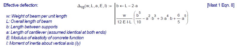

I have been trying to follow the design examples in the PCI publication noted above but I cannot find how to calculate the value referred to as "Δcg". It appears to be function that needs certain variables but I do not see the function or formula anywhere in the document.

Are you talking about this Δcg?
That appears to be it. I could not find it in the pdf version of the text that I have. I looked with my eyes and used a pdf search routine. Never found it.
Thanks a million.
