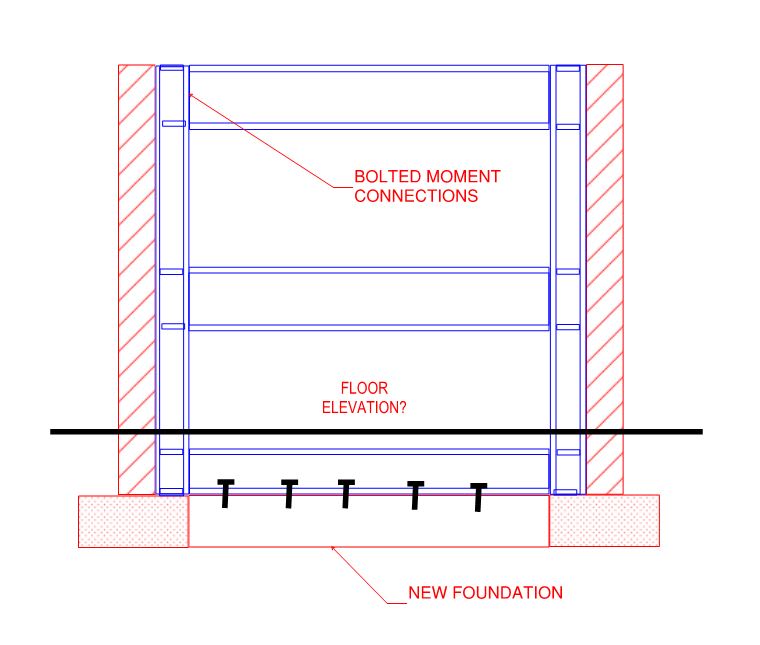

C) Per the sketch below, this might be a good application for a system that our European cohorts favor. If you're going to go with discrete pad footings and no low beam, I'd do this:
a) Chip away the existing wall footing adjacent to the new pads.
b) Case in the new pads dowelled to what's left of the old footings.
c) Call your bases either pinned or only fixed for closing moments. I think that opening moments might cause you trouble with:
i) the limited DL that you'll have to resist OT and or;
ii) detailing moment transfer at the joint for opening moment.

European Option
I'm always in favour of stealing from our European brethren. I recently incorporated a predominantly European move into my arsenal as a tendy and my beer league game has never been better! Bet you a timbit only Canadians will understand that last sentence
I like this configuration. The statics of overturning and such are similar so it doesn't change much in terms of mass of concrete needed in the footing (EDIT - this is true if designed independent of existing. But I suppose if the footing is reinforced to act as a single rigid body one might comfortably rely on shear dowels to engage adjacent CMU without having to develop a moment connection and that WOULD reduce concrete required in the new footing). But regardless it does simplify the connection to the footing (i.e. makes it easier to distribute loads into center of footing mass). Would you agree that the bottom beam primarily acts as a load distribution mechanism to the footing or do you see another advantage (it obviously acts as a tension tie in gravity loading but to me that would just be bonus)?

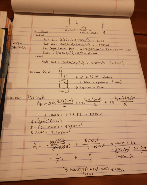

However, I do have a question with regards to the CMU layout based on the scan. To preface this convo: I have very little experience with unreinforced CMU, and at the moment my office Masonry Code is with my brother (I’m extricating it tomorrow to see what I can glean).
The CMU wall is laterally unbraced for the most part. The middle floor starts 14’ back from the exterior wall to be replaced but this just provides a pinned joist connection. The nearest perpendicular, sheathed wall, is 40 feet back into the building.
I am unsure how to feel about this. I can restore lateral support at the portal without issue but the existing construction seems a bit lackluster. This document from the Canadian Concrete Masonry Producers Association suggests that empirically lateral support would need to be provided at a H/T ratio of 20 ~ 17 feet in this case. The building is approx 25 feet in height and as I mentioned, the nearest true lateral support inside the building is 40 feet from the portal.
Interior of the building is finished to the 9s and any invasive work would be quickly condemned. So, I am wondering the following:
A) How do these spans feel from an experience perspective for unreinforced CMU? Like I said, I have little and Drysdale (author of document above) is the Canadian go-to when it comes to masonry and the limits he suggests are not observed in this case.
B) If the lateral support is wanting what does one suggest if interior work is frowned upon?
You should be able to squeeze enough strength out of it to show it works. I just ran a quick check of a 14' long, 25' tall URM wall (10" thick nominal, 1500psi f'm) with 15' feet of roof trib (15psf dead, 20psf live, 40psf snow) and a wind pressure of 18psf and it works without issue. This is using US codes and I'm not sure what your design wind and snow loads are going to be, but I think there's hope.
Thanks phamENG. Good to know the proportions we are looking at are not that far out of the norm.
That said, taking a walk through our masonry code leads me to believe that the wall fails a tensile resistance check when considering it a spanning element from grade to the roof. I imagine there might be a way to take into account arching of the compression face to increase wall capacity but I didn't see it in our code (though I am a newbie when it comes to CMU). Are there other checks than tensile resistance that might allow this wall to fly?
BTW: Below are my calcs (A/S values for 240mm CMU per CCMPA). Perhaps you could take a look and tell me where I've gone wrong (I assume I must have given you said your quickie checked out)? One thing I included that you may not have was the fact that the wind uplift on the roof counteracts the roof DL, and given the eccentricity on the wall, this enhances the bending moment. You'll note that I neglected the amplification factors because this would only make matters worse.
EDIT - I suppose you could consider it spanning the other direction b/w the portal and where the second floor comes into the picture. And assume the wall starts to span between stories at that point. But while that is much closer to allowable the section still cracks (I get about Ft=0.33 mPa > 0.24). Also, the problem with assuming this span direction is load is going into the second floor but the nearest shear wall is an additional 27 feet into the building. That's a long way to go for unidirectional shear transfer on a residential floor (I would think anyways) and I would be concerned about how much got resolved via the diaphragm vs deflecting the building. On the other hand, it's been in existence this way for some time and that deflection hasn't been of note/concern.
I could probably just add some weight onto the parapets to resolve the Ft issue. And say that the performance in service otherwise has been acceptable and so not worry about the current load path so much (as it has been that way since the build a few years ago).
You are correct - I didn't consider uplift in my 'quick and dirty' calculation. I also didn't realize how high your wind loads are. Wow. That's not much lower than what we deal with here at the northern edge of Hurricane country. 1.4W comes out to about 25psf for strength design...we're usually around 25 or 28 for houses around here in similar conditions. I would have expected yours to be a bit lower. Shows what I know...
My apologies for giving you false hope - an underestimation of your loading requirements and lack of knowledge of your load combinations led me to give you bad advice.
Hmm...it works for every ASCE load combination that doesn't involve wind or seismic. So when you break the bad news to the owner, you can at least tell him that the calculations match reality - he hasn't had any problems, but he hasn't been through a <insert Toronto's source for high winds here> or an earthquake yet. And if he does, his walls will probably crack apart because they failed to fully reinforce them where it mattered.

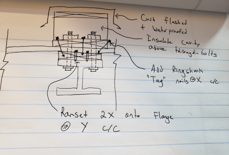

I’d build out a curb to make weather-tight my new connections. Plus add some sort of conventional nailing pattern just because.
A) Does this look like a decent conceptual detail?
B) How do others accomplish this? Is it just a 2x on the flange + nails from above and calling it a day? Any concerns of wood degradation around fasteners over time (or do people say meh to this as that’s a condition nearly everywhere)?
Enable said:
I figured simple nailing would not be reliable enough
But...that's how 99.9999% of wood diaphragms hold to their vertical LFRS. And I don't think your detail solves it anyway. You've added a lot of fasteners...but they all depend on sound diaphragm sheathing. Water can still leak here, and one might argue that it's more prone to a leak with all the fancy curbs and flashing. At least, most of the structural damage I've seen from flat roof leaks happen at seams - particularly those at the base of a curb or at the curb flashing.

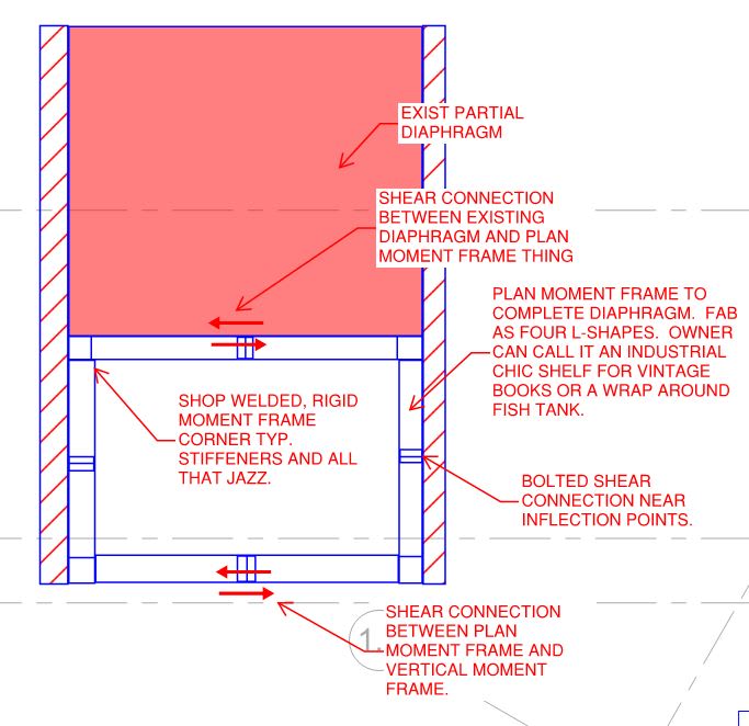

3) Given that your partial, second story diaphragm probably represents a three sided diaphragm stabilized by a relatively soft rear shear wall setup, I'm not sure that diaphragm should be counted as wall bracing even where it does exist. Under seismic, the floor deck may actually count as out of plane lateral load on your walls rather than bracing.
HAIL MARY ATTEMPTS TO SALVAGE UR PROJECT
4) Maybe check Ontario's Part 9 section on residential construction to ensure that we're not missing some easy out here that one of your competitors might pick up on. I don't know of such an out off hand but stranger things have certainly happened.
5) Being Canadian, I also have the Drysdale book. He's actually very aggressive with some of his masonry design recommendations. For seismic, I believe that he actually has a procedure that allows the wall to crack in tension and continue to carry load as two diagonal struts, above and below the crack. Whether or not one can make a similar argument for wind load, I'm not sure.
6) The sketch below shows what I consider to be a slick, minimally invasive fix for this. Even if the client doesn't bite, I feel that proposing it would demonstrate some creative thinking and a willingness to innovate which is worth something.

Nails enough for lateral. Typical of wood.
Agreed that it is typical and probably enough. But I don't really enjoy thinking about how it, on a poorly maintained roof, will work over time. To me the bolts are better because instead of relying on bearing around the hole they induce friction that itself is enough to accommodate inplane shear.
But I will admit they are perhaps needlessly out of the ordinary for this kind of construction. I could probably be comfortable with the ramset 2x member + nails combined with screws going from the underside of the flange through the 2x member into the deck c/w fender washer.
KootK said:
That's a much different interior structure then I was envisioning so thanks for the idea! I also am concerned about the second floor for similar reasons, which is why I didn't consider it in my first go. I already put the idea of an interior portal further back into the home to cut down the span and that was immediately rejected due to the intrusive nature. I'll put this one to them in hopes they might like the look!
Project Update
Owner is okay with risks of core-filling and the GC is being forced by the owner to perform the work (he has a few other jobs with the same owner on a much bigger / commercial scale). So looks like we are not done....yet ha! However, I still have some masonry issues even with core-filling so I will be posting a separate thread in the structural forum. Should be fun!
I disagree strongly with that. A friction mechanism requires pretension throughout the various faying surfaces in the joint, including the wood interfaces. Problems with that include:
1) I know of no reliable procedure for generating that pretention predictably as we have for slip critical stuff in steel to steel connections.
2) Any induced pretension is going to fade away over time as the wood creeps.
