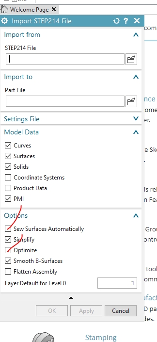

Hello, Is there a way to improve the results of a step file import into NX? I can import a step file or iges file into NX and the file will be imported, but the part will be made up of hundreds or thousands of bodies. Is it possible to have it so that there's only one body?

there are a lot of ways to import step into NX.
If your using File-> Import you need to pull down the options tab and check Sew.
If your step file is an assembly and you don't want it to be, check flatten and it'll bring it into a single file.
If you drag and drop you'll need to edit your step203ug.def and step214ug.def files
If your using File-> Open and filter for Step, click the Options button in lower left corner to access the settings
