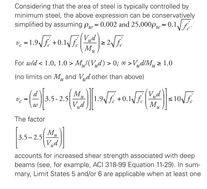

According to ACI shear design procedure, the shear design value is taken at a distance d from the column face. However, due to demanding architects and owners, I often find myself with high concentrated loads at a distance less than d from the column face causing a huge peak in shear value at distance less than d. I attached a drawing of a beam with a high concentrated load near the support so you could know what I typically deal with. Increasing the beam depth would of course allow the design software to ignore this peak because it's at a distance less than d.
For these cases, do you think I should be designing for the shear value at the column face directly and neglect the effect of increasing the beam effective depth "d"?

Design for the shear value at the column face. ACI 318-14 even shows the critical shear section (at the face of the support) for a load applied within 'd' of the support in Figure R9.4.3.2(f)

the beam becomes a deep beam and you need to design the region following strut-tie methods.
ACI makes this pretty clear in the deep beam definition, where the condition is an "either":
1. clear spans equal to or less than four times the overall member depth; or
2. regions with concentrated loads within twice the member depth from the face of the support.
You fall under condition 2.
An alternative checking procedure that I support is to use shear checking provisions suitable to shear cracks steeper than 45 degrees as described in CRSI's design guide on pile caps. Strut and tie is near and dear to my heart intellectually but, as a production tool, it's painfully slow unless I've already gotten it automated somehow. As a matter of personal judgment, I will also insist on real bottom bar anchorage in this situations rather than the "standard hook past the CL of support" option. That, as a nod to what I expect the result would have been if I did STM.

I don't get paid well enough to do a manual strut and tie method on every similar case, and I think that contractors will give me a headache over the steel arrangement. So I will use straub46 suggestion with Kootk formula as a check, with the strut and tie method option only for very high concentrated loads. I will also write for the structural design software developer (PROKON), to consider shear values at distance d for concentrated loads, and hopefully, I could get a discount.
