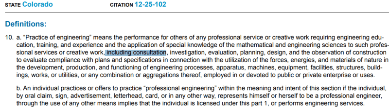

Some states consider consulting under the umbrella known as the practice of engineering. Try deciphering the below text.

Basically, ANY math and physics applied to ANY covered discipline makes it engineering; the citation below is from the California PE Act, and it's purposefully written vague and broad to catch even hints of unlicensed engineering.
6701. Professional engineer defined
“Professional engineer,” within the meaning and intent of this act, refers to a person engaged in the professional practice of rendering service or creative work requiring education, training and experience in engineering sciences and the application of special knowledge of the mathematical, physical and engineering sciences in such professional or creative work as consultation, investigation, evaluation, planning or design of public or private utilities, structures, machines, processes, circuits, buildings, equipment or projects, and supervision of construction for the purpose of securing compliance with specifications and design for any such work.
