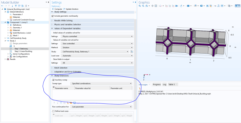

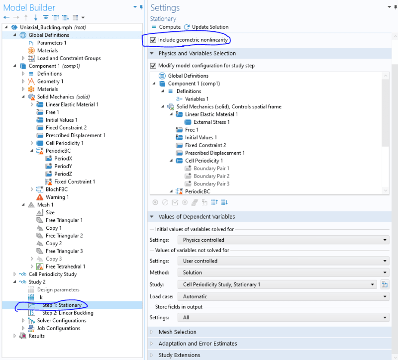

Could you give me some pointers on how to get started with the continuation solver? - I did tick "Include geometric nonlinearity" at Step 1 and Step 2 in my study, but cant find the continuation solver and its settings.
This continuation solver is basically Auxiliary sweep in Study Extensions tab of the Stationary solver menu. The whole procedure is described in the article "Buckling, When Structures Suddenly Collapse" available on Comsol’s website and there are also some examples in Application Gallery.
Thank you FEAway, before I wrap up this thread could I just ask:
Do you think its necessary to add anything in the blue circled area?
I have this sweep (k-values) already set, not sure if theyre related.
And when I run the study this way, is it correct to say we are investigating the influence of geometrical nonlinearity under finite deformation?
Yes, that’s where you add the continuation parameter.
I think that you can call it this way.
