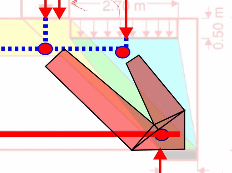

Currently refreshing myself in the world of STM with the current situation: a transfer wall with two columns and beam framing into the top of it. The reactions from the columns and beams are roughly similar in magnitude.
What advice would you give for dealing with the overlapping struts from the right hand side column/beam?

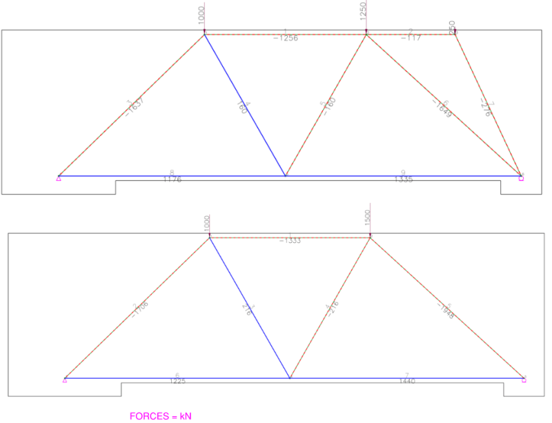

Ideally the STM would be a simple truss like so, however it gets tricky setting up the nodal regions and the longitudinal axis of the struts.

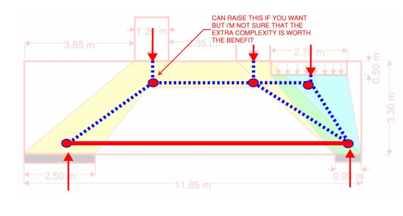

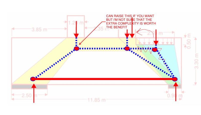

Finally... we're so overdue for an STM thread. I favor the model shown below. I feel that, one you adjust the flexural and shear depth appropriately to deal with that notch, the overlapping strut issue is self resolving.
I also think that you could use this very simple model conservatively and without sacrificing much efficiency. Your limiting factor may well come down to that node where the two struts meet up anyhow.
Obviously, you'd have to also not be ridiculous about discontinuing intelligent bar detailing beneath the beam etc.
So would you design the struts that end up overlapping as the vector sum of the two and apply the appropriate conservative assumptions to strut size?
Modelled properly, I don't feel that the struts do overlap. I haven't fully thought through the nodal geometry below but the gist of it is apparent I think.
For the simplified model that I posted above, I don't feel that any vector summing is necessary. Just the straight up moving of the load as I illustrated. As I mentioned earlier, though, one still needs to keep their wits about them with the detailing. If the final answer is just stirrups, tie bar, and skin bars, AOK. On the other hand, if each load needs a diagonal, mini-column cage to make it go, then that's different and you'd still need that under the beam.

It might be interesting to work thru this example. I find it difficult many times to finally land on a layout and most examples I seem to find do not have many complexities. I read a recent study for a beam with openings where the engineer did 4 STM analysis and then found another solution as well.
@KootK - I agree with most of your sketches above - however, do you have a good reference that assists setting up the proper STM geometry. For example, best way to define strut/tie axe between centres of bearing, what the nodal angles should be? How to deal with multi-strut nodes? I find most examples are very simplistic.

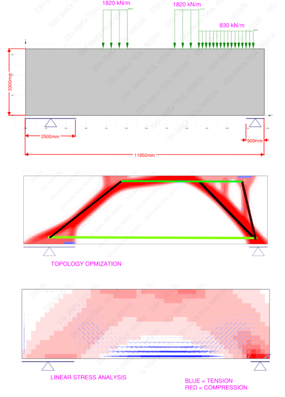

@Brad - what software are you using there? We've recently got our hands on Idea Statica and I've just started exploring a solution to this problem. The stress diagrams are very similar.

That is output from AStruttie and IDEA Statica Detail. I am in the midst of evaluating Idea Statica for our office so I setup a quickie model. If you have not gotten a copy of the Idea Statica CSFM book I suggest it Link. It goes thru the material models and theory in good detail and explains the focus on creating a tool that is useful for everyday applications.
