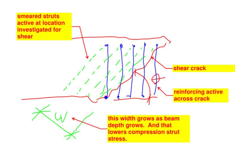

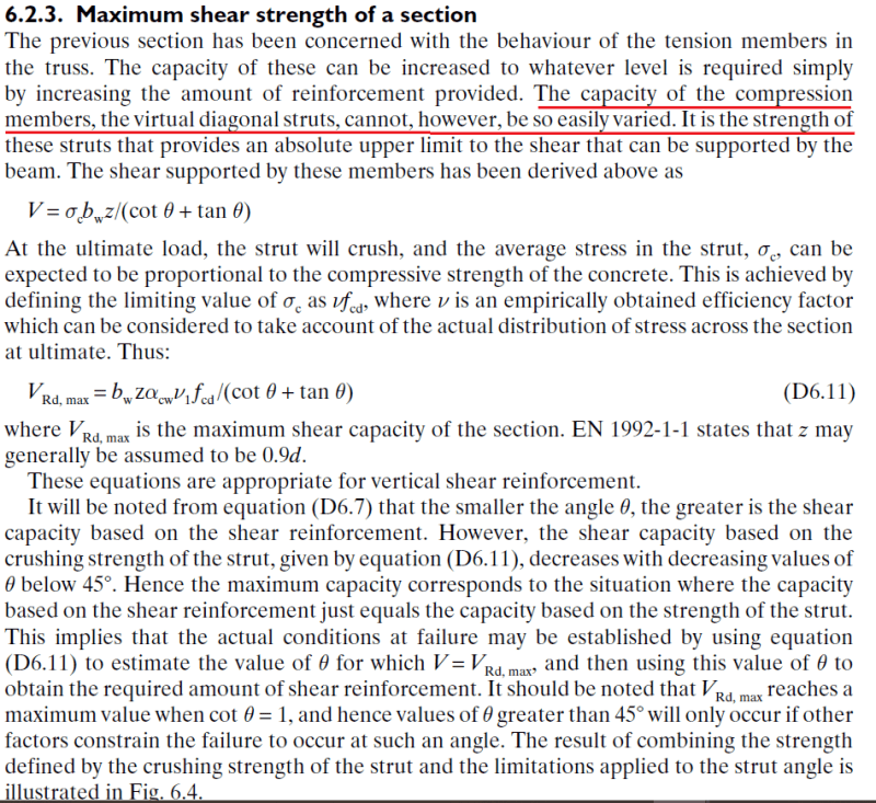

Thanks for the reply Kootk. but the diagonal struts spacing doesn't increase or decrease depending on the amount of shear reinforcement present in the section ( for stirrup, I don't have full information on CFRP). according to Eurocode the minimum angle the strut can have is 22 degree and the maximum is 45 degree. the strut inclination can vary between the two depending on the amount of shear force it is sustaining. for a given depth at 45 degree one would get the maximum diagonal compression force the strut can carry, after that only increasing the depth is the way to go. please check the attached pictures for further clarification.

I didn't say that the strut spacing changed. What changes is the total width of smeared concrete struts that contribute to resistance at any given location where shear is considered.
Alas, sketches are always the way...

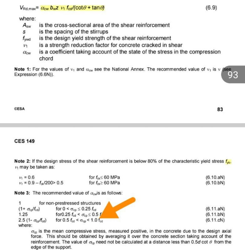

I would have thought the only way to increase VRD.max would be axial compression from PT.
I think rapt is pointing in the wright direction.according to eurocode 2, memebers subjected to axial compression will experience enhanced level of Vrd,max. But this is if the provided axial compression is below 0.5fck. Beyond this limit the benefit start to decline gradually becoming zero at 1*fck. With externally bonded prestressed CFRP, the shear capacity can be increased while the constant moment type balanced load helping in flexure. I think this is the way.

It is fcd, not fck. Divided by the material factor and multiplied by the long term factor.
But you would never use a compression stress greater than about .45fck anyway due to non-linear creep effects.
