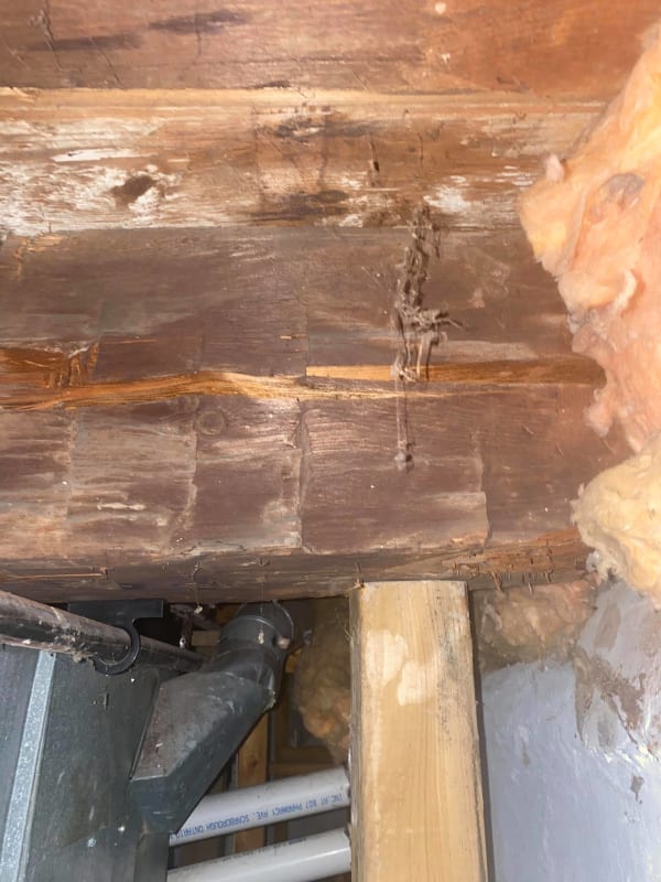

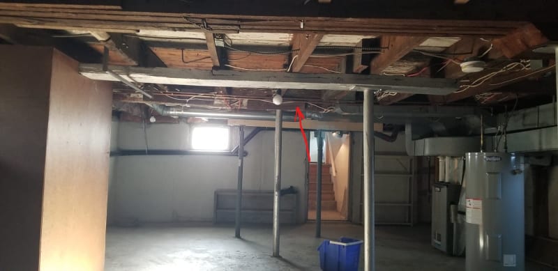

I am looking to find a viable solution to fix a cracked beam that is sagging. The issue is that there max 2 inch clearance between the beam and the furnace below, which is also the lowe point of the beam. see below
My proposed solution is to add 1/4" thick steel angle (i.e. lintel) below beam and support it at each end. The steel angle is the only thig I can think of to be able to slide between the beam and furnace, see below.
Any suggestions?
Thanks in advance.

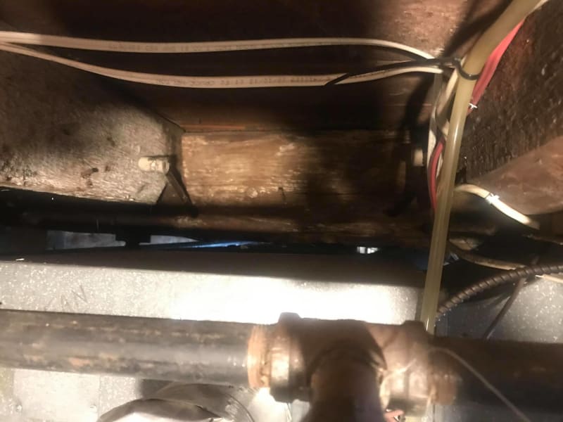

What is the connection detail of the floor joists to the beam? How do you "notch" the floor joists, to fit the angles, without detaching the joists from the 10 x 10 beam?
If you can put one new column on one side of the ductwork do you really need to install the angles? reducing the beam span may be enough to avoid "fixing" the beam.
If you can put one new column on one side, can you put a new column on each side of the ductwork and don't use the angles?
The beam and the joist are notched, the joists run through the beam. Hope the image below clears it up.
Two acrows?
Looks to me like this is the old timber frame connection where a slot was cut partially into the main beam to provide the "beam hanger". The joists do not run through the beam.
Looks like crack in beam is located at the bottom of the notched end joist beam seat. Is the second photo of the opposite side of the beam? Crack looks smaller on that side, if so.
Think your idea of a steel post with saddle on either side is a good one. Is the floor slab thick enough to carry the post load. In a house that old, it might be pretty thin - depression era cheap?
Could do pier block with adjustable post (Simpson Strong Tie) and 6x6 post. Then you could jack upwards to take out sag.

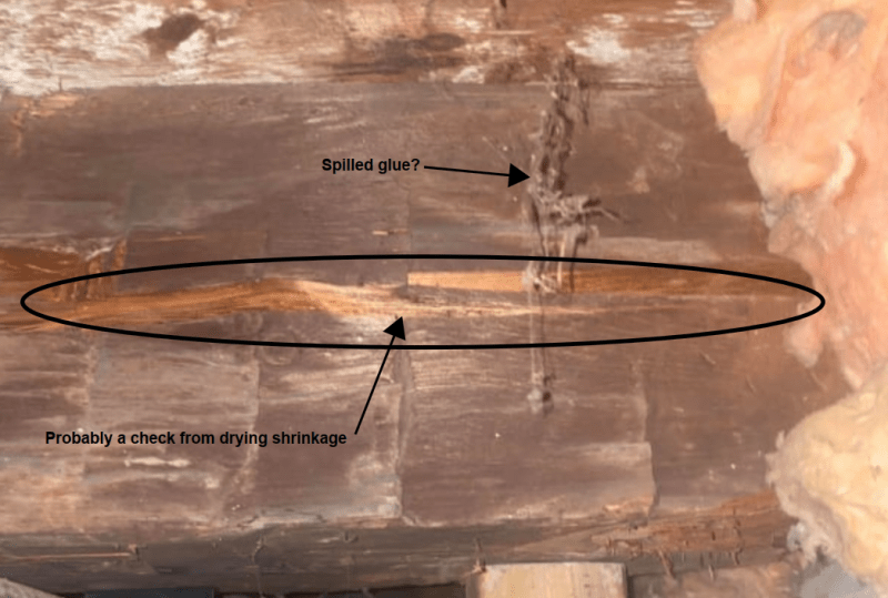

does this look like shrinkage crack? should I be alarmed? see close up picture below.
Does the crack go all the way through? It could just be typical checking of old growth timber. But the sagging is potentially a bigger concern. And jacking it back up may cause more issues than it fixes. Jacking the beam could cause finish damage above the beam if the sagging has been in place for a while. If it is new sagging, then what has changed to cause it? Higher moisture content of the area? Change in loading? If it isn't new, then be sure the fix is absolutely necessary before going forward with it.
The crack doesn't go all the way through the beam but its fairly deep and wide.

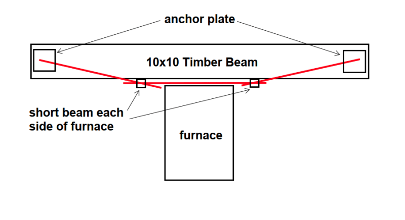

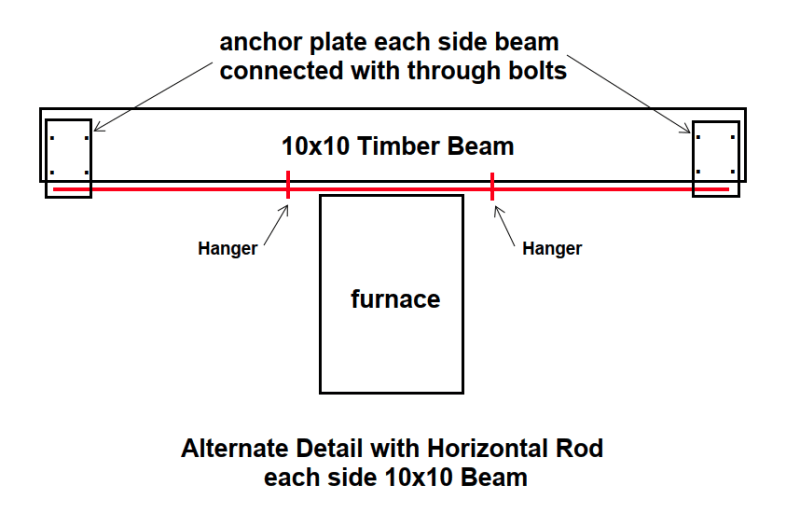

I suggest using threaded rods as shown in red each side of the timber beam. The rods at the two ends could be attached with steel plates fastened with glulam rivets. The sloping rods put an upward force on the short beams below the 10x10. The horizontal rod would be tightened with nuts and anchored with a lock nut. Sloping rods would need to be drilled through existing joists.
BA
I can't see the advantage of sloped rods.

I believe that sloping rods makes the connections to the beam a little easier, by riveting anchor plates to the sides of the beam instead of the bottom. Sloping rods provide a vertical reaction to the beam each side of the furnace, which a horizontal rod does not provide. One full length rod is probably not feasible because of basement clearances, but three rods would be more manageable.
If the end rods are horizontal, the connection to the beam could be a plate riveted to the underside of the beam, but the connection to the rods would be difficult. Could use a plate each side of the beam, but that would have to be designed as a moment connection to the beam, always difficult with timber.
BA
This could work if there is sufficient clearance to get the rods in place. Otherwise, they would have to be spliced.
BA
I was thinking the sloped rod would develop a very high tension because the distance to a supposed neutral axis decreases, as would happen in prestressed concrete design, no? But since it is not continuously bonded, you may be right in it acting more like a truss member. In that case the sloped rods load is set by the tension in the horizontal rod, and the beam starts to pick up the moment as we move from there toward the ends.

Could the OP place arrows on the pictures showing the location and length of the crack in the Beam, as I can not see this crack?
Is it also true that the crack does not go thru the entire depth/thickness of the beam?

I interpreted the crack as shown below. The crack may not affect strength too much, but wouldn't hurt to give the beam a little help.
BA
