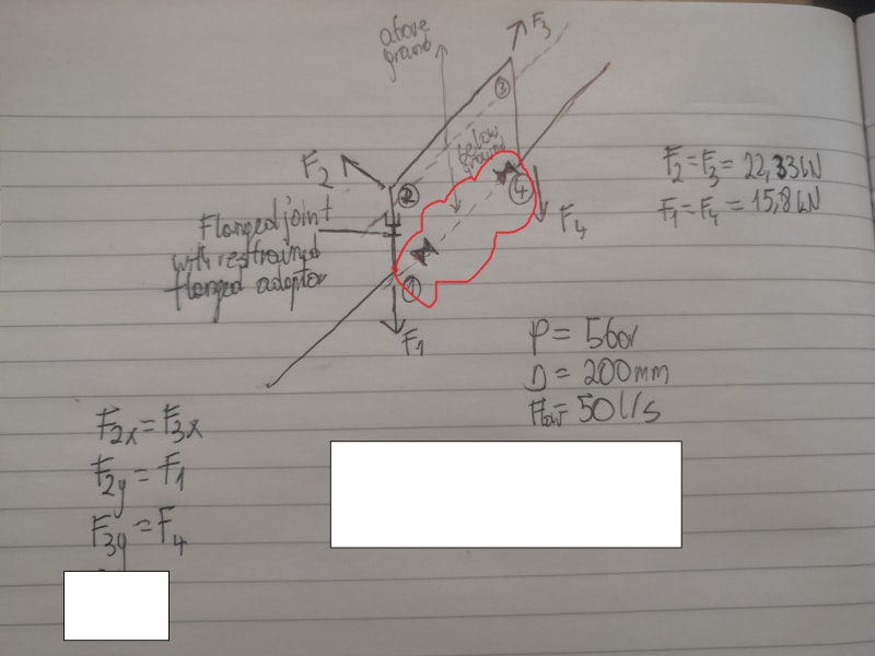

Hello all,
I am trying to analyse segment of the pipe as per attached sketch. I drew a simplified thrust force diagram from system pressure and mass flow. Between point 1 and 2 there is a restrained flange adaptor or flanged joint. Would I need to consider longitudinal stress coming from bending moment as a result of F2x acting on lever arm between point 2 and this flanged joint? The horizontal part of force F3 (F3x) seems to counterbalance the force F2x which would give me a bending moment.
Thanks a lot!
 https://files.engineering.com/getfile.aspx?folder=2d0bbc55-1ee3-451c-b877-48724c1df5f1&file=IMG_20210419_142223.jpg
Your joint elbow thrust loads are balanced by tension created in the pipe. That will elongate the pipes. The elongation create displacements at the joints which will introduce secondary bending moments.
Hi ANDREW,
What is the dashed line at underground section btw. points 1 and 4 and the valves ? If the dashed line is a by-pass pipe conn. btw. 1 and 4, and these connections constructed with Tee, no moment will develop at above section and so at flanged adaptor..
Hi both,
HTURKAK,
Dashed line shows permanent line that is isolated. The bypass line is between 1-2-3-4.

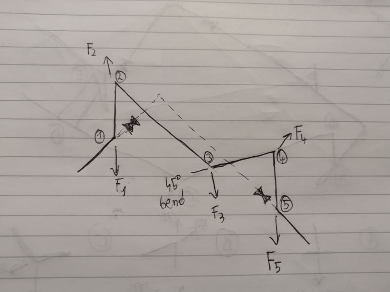

What would happen if I had a bit more complicated temporary pipeline as per the file below? Temporary line is between points 1-2-3-4-5. However, this time there is an additional 45 bend and pipework between bends 2 and 4 is made of HDPE (electrofused) as oppposed to the rest that is ductile iron. The horizontal part of the force F2 will be much larger then opposite force coming from F3. How to get pipe 2-3 elongation if it has forces of different magnitude at both ends?
Thanks again,
Andrew
Andrew, you didn't mention the pipe material before. The Welded steel pipe I assumed it was may act differently than ductile iron. The type of joining is also important. How are the pipes connected? Push-in, glued, fused, mechanical clamps? Some are very limited and won't take any pipe tension.
Generally adding turns and offset angles can decrease pipe forces, since the pipe has more freedom to flex and thereby release stress. The more rigid these are, the more stress results. Flexibility decreases stress, but allows more movement.
First I need to know more about the joining method. The only way to have tension in the pipe working for us is to have joints that will not separate and pull apart. Otherwise we will have to find a different way to ensure that won't happen.
1503-44, The ductile iron pipe between points 1 and 2 has one end load restrained flange adaptor, same between 4 and 5. The bends in points 2 and 4 and flanged ductile iron. The PE pipe (2-3 and 3-4) is electrofused and connected to DI bends with stub ends. The 45 bend is also electrofused. Pipework is fully restrained. My only worry are possible bending moments acting on flange adaptor/flanges on vertical legs.
OK so 2 to 4 is HDPE pipe. Rest is DI.
THE HDPE is very flexible in relation to the DI and the geometry is much more flexible as well.
Can you tell me the lengths between bends and diameters of the pipes.

Oh. I didnt realise the pipes were that long. I thought maybe a few m. I'd plan on putting in at least two supports under the HDPE, one 5m from J2 and another 7m from J4. You can do that I hope, because 18m with a horizontal bend in the middle that could sag a lot, would put a lot more moment than I expected on those risers. 2 additional supports??
Yes, pipe will be properly supported as required by the manufacturer - probably sandbags which should allow for pipe movement and won't make it rigid.
I am still not sure how to investigate bending moment on vertical segments in easy way. If I were to consider that F2x force is about 113.1 kN and the opposite force on 45 bend F3x is 33.1 kN I get 80 kN of force that acts on bend 2. That is quite a lot to be taken by a flanged joint (80kNm) so thinking how I could prove that it is way too conservative and joint can take it...

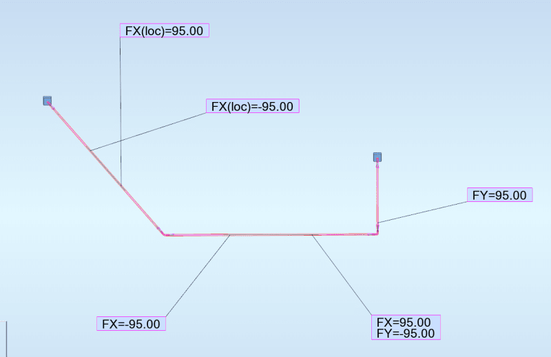

As you suggested, I modelled a pipe as a space frame using tubular section and PE100 properties and assumed that pipeline is fixed at both ends ( rigid DI risers). The beams are modelled as members on elastic ground.
I assigned following loadings based on 16 bar pressure (overkill but conservative):

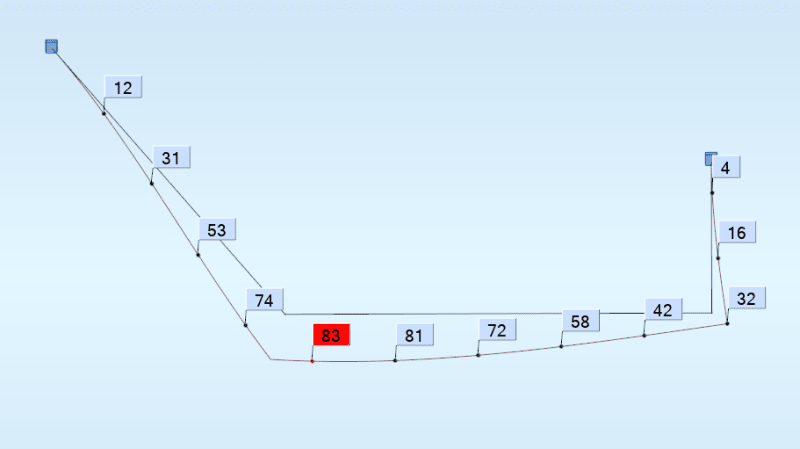

Based on above I obtained following displacements , which are as expected based on earlier discussion:
The normal stress for this scenario is about 5 MPa which is much lower than PE pipe tensile strength of above 20 MPa. Resulting moments and forces are also very low as pipe doesn't offer much resistance (it deflects).
I know I didn't take into account thermal stress but here pipe is free to move so again I believe this can be neglected. The Poisson effect would probably increase tension in the pipe but this again should be low.
Please, let me know whether my conclusion are correct.
I can't check your math, but the diagram looks absolutely perfect.
You are good to go.
