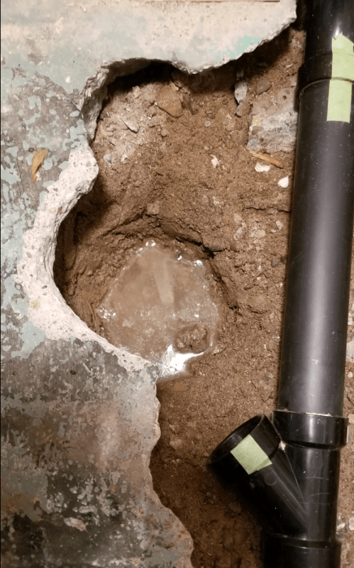

These are pictures for a small project, replacing a bath tub with a shower and changing the position
Short story: it is not drying out and I am wondering if the pipe/joins cracked when the concrete cured or
it is because of using the wrong type of concrete and too much water.
I poured the concrete (both types, see below) on March 29!!
Here is what is under concrete
Here is before pouring concrete
Here is within a week since I poured the concrete
And here is the situation as of yesterday

You're concerned because it's still that darker colour of grey? Looking like it's moist? I would say in 2 weeks I've seen some concrete still have that green (wet) look to it. It could also just be a different concrete mix/different aggregate is causing a different colour. Some of those bag mixes I've used have an extremely dark natural colour to them.
Is it hard when you press on it with a screwdriver? If so, I wouldn't worry about it too much if you're confident you have no plumbing leaks or source of water below the repair area. If there is a source of water below, you'd want to find out what's causing it, but it's affect on the concrete should be your least concern.

I am concerned with the fact that it feels wet
In one of the pictures you could guess a hair dryer that I used to dry up the patch -it turns lighter but then after a while it gets back to darker
and it forms that white efflorescence, so I am not sure if it still cures and it still dries up after so long or there is something else. Se my next comments for miningman
@miningman
As someone advised I added some gravel there to break the humidity propagation. That is why you see gravel in the second picture
Now having that gravel layer should prevent the humidity from ascending toward the surface and my wet like looing patch should dry up.
In beginning I suspected the curing concrete cracked open the cemented joins and I had a leak at the bottom end of the elbow
So I made sure that no water is flowing through the pipe anymore (I had just the condense pump from my furnace pumping like 1 liter of water once or two times in 24h. SO I disconnected that but the patch still feels wet and if I dry it up with a hair dryer it gets wet like
Don't get me wrong the concrete is rock solid but it does feel a little bit wet -leaving a piece of tissue on top of it hardly collects any humidity but I still see that efflorescence forming

Post hole concrete pre-mix has a bit lower cement content. Definitely more permeable that a 4,000 psi mix. About $2 extra per bag, just to rub it in.
However, you might have a moisture problem, and you need to figure out the source before proceeding.
Drill a vertical hole or two through your new concrete, and before you apply a cementitious topping for observation. Make sure there is not positive pressure. Even if you tile over concrete that have positive pressure behind it, it will probably continue to give you problems.

I am quite sure the humidity gradient is from under the slab toward the floor surface and into the room there is no question about that
How come the other path of concrete is not experiencing the same issue ?
One detail that is worth mentioning is that the humidity of the dirt in that opening changed over time
It stayed dry in the winter and it was a little bit more humid when the temperature raised (I live in Toronto)
I had to dig the dent to make room for the P trap and you can see that in the first picture; no water was observed during that time
The next day after the day when I finalized the dent to make it deep enough I could see some water collected in that gap
This also coincided with a very heavy rain (I think it rained the entire night)
Once the P trap was in I added dirt back to set the surface level and then I added gravel
However as you can see in the picture the space above the P trap was not sealed and it can bread so if any more water accumulates there I should see humidity or water around he drain where the gravel is visible. That spot is marginal to the entire wet areas
That is an obscene amount of water ponding only 6 inches below your concrete surface . Strongly suggest having a local contractor look at the area and making corrective suggestions. My guess is it will require extensive and expensive drainage before any more concrete is applied.
After removing that water it went away and it did not collect again
It was a one time since August since I opened that area and my guess is that it collected there because it was the lowest point and it percolated from the area around it.
